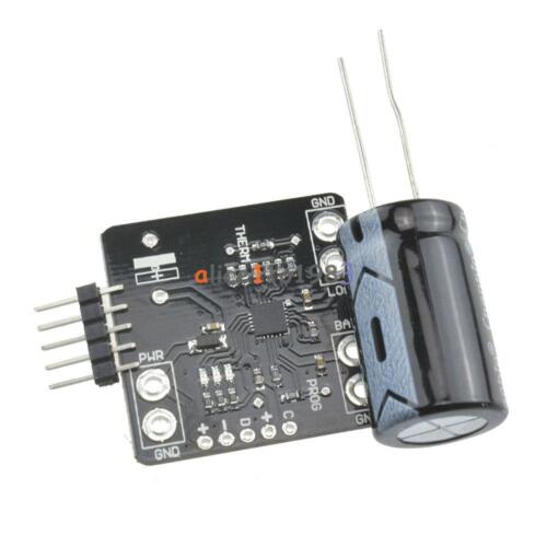

I've confirmed that the load sharing circuit I offered in the previous post doesn't work with solar. The mosfet doesn't switch properly when the input voltage is variable. The MCP73871 charger chip apparently deals properly with solar, and includes load sharing. There are modules with that chip, and if the charging and discharging current limits aren't a problem, that may be the way to go.
However, note that the module has no USB connectors.

Thanks for the heads up about the MCP73871, I'll be checking it out.
MCP73871 on order. Meanwhile, I upped the solar cell from a 10W to a 20W. The time of day the solar cell is putting out 5V is earlier in the AM; 0600 instead of 0700 and charging was done in 1.5 hours instead of 4 hours. I am on day 3 of testing the the 20W solar cell. The solar cell remains in partial shade, to create a less than ideal operating condition.
