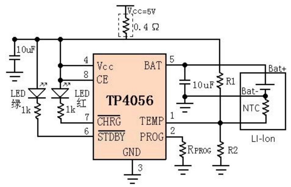

Hi Everyone,
My aim is to build a simple solar powered pump with a rechargeable battery to water plants.
The idea is to use a 6V 1W Solar Panel connected to a TP4056 (protected) to charge a 18650 Lithium Ion Battery. On the output is an MT3608 2A Boost Converter to step up the voltage to a 3V/6V DC Pump.
I would like to know if the design work and any correction/ improvements on different components or adding in a timing function for the motor.
I have attached a diagram for more information. I am a total beginner and would really appreciate any help or advice.
Many thanks,
Jack
This may seem like a simple project, but it is not.
The boost converter may not work at all, because the startup current for motors is 5 to 10 times the running current, and there should be no need for it anyway. A 3/6V pump will work fine on 3.7V supplied by a Li battery.
The charger won't work properly if the motor is running, because it is designed to charge only batteries that are disconnected from any loads. Furthermore, if the battery is discharged too deeply, you will ruin the battery and/or the charger won't even start.
For beginners working with solar power, lead acid or NiMH batteries are the way to go. Both can withstand a great deal of abuse. Li-based batteries cannot, are easily destroyed and in the worst cases, start fires.
You need to do the maths to figure out how many amp-hrs the pump motor will need over (say) 7 days and how many amp-hrs the solar panel can produce over the same period. If you have cloudy days where you live you must take that into account.
I suspect you should have a solar panel that can produce about twice or three times what the pump motor needs (averaged over a week) to allow for all the inefficiencies in the system.
And I agree 100% with the suggestion to use a lead-acid or NiMh battery. If you are using a lead-acid battery make sure it gets a very full charge at least once per week. I don't have the same experience of NiMh batteries but the same care can't do any harm.

That's a really good point regarding the boost converter. Since the power from the solar panel can fluctuate, I wanted a component to stabilise the output. After reviewing the diagram I realised that it was not serving its purpose!
This model of the TP4056 is the updated version which I believe has over discharge protection - this should prevent discharge damage to the battery. However, I agree that a lead acid battery would work better for this function. I think the TP4056 is only compatible with Lithium Ion and is designed for the 18650 battery.
I am confused why the TP4056 will not work properly while charging the battery as there is the option to connect a load on the board.
Do you have any suggestions on how I could adapt this idea to work?

The TP4056 is not designed for load sharing. The charge cycle assumes that the battery is unloaded, and does not work correctly if a load is attached.
Here are a couple of posts/articles that discuss the various problems:

You are right, I never realised this was an issue! I've done some research and there are very limited charging components which also offer load sharing. However, I was able to find a charger developed by Adafruit with load sharing but it is too pricey! Do you know about any different chargers with load sharing?
