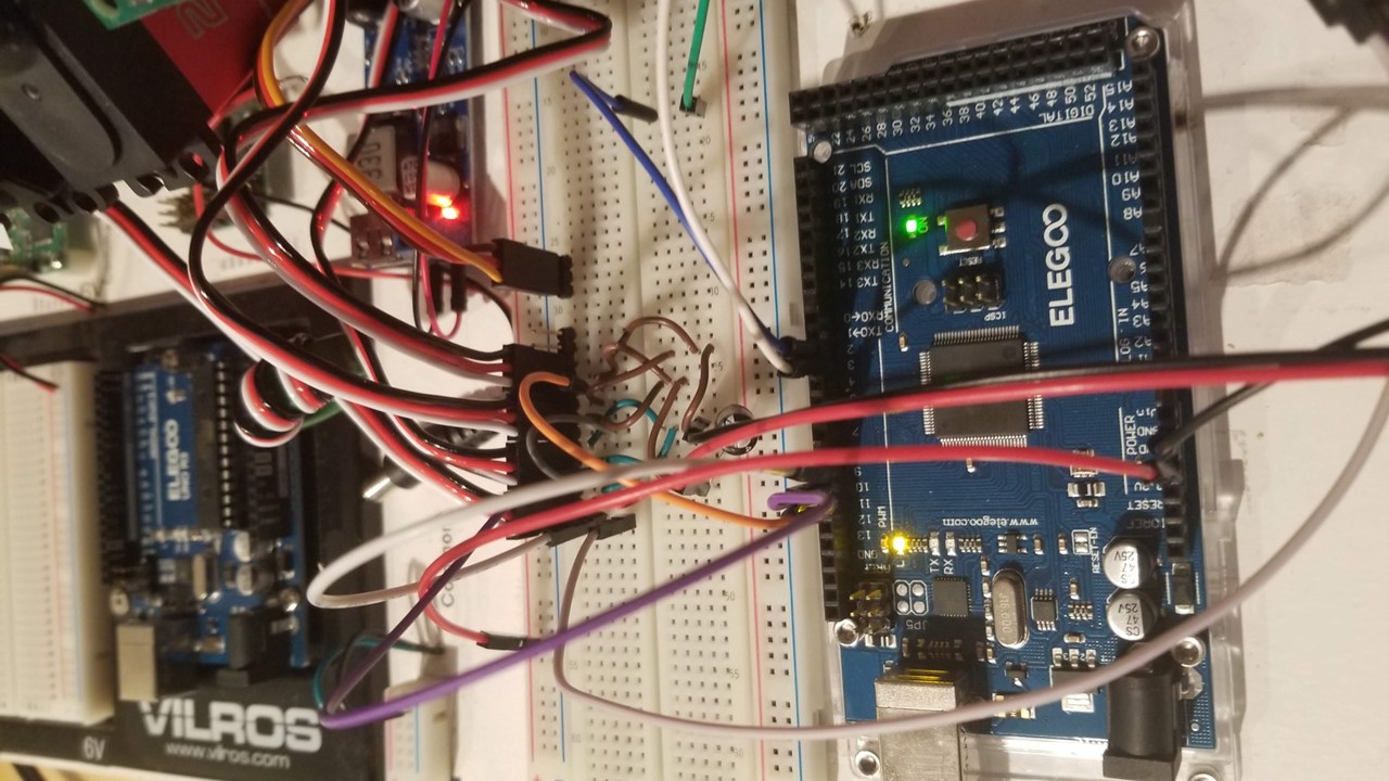

Attached is a working, but still in development, Gunfire Control System that I wrote with all of your help and suggestions. I used Mobatools to control servo rotational speed and ServoInput Library(primarily for servo angle). I did not use Servo library, because I read on here that Mobatools may interfere with Servo library.
In any case, the program controls the servos as intended, but there is a fair bit of servo jitter and periodic twitch, even with just one servo connected. The jitter is not much, but when amplified by a 12" long turret and barrel, it would be very visible.
I do not have that jitter/twitch when the servo is connected directly to the receiver (i.e. no arduino). I have a separate power supply for my servos and receivers, a 100 uF Capacitor across the servo power, ferrite core wrapped around my servos. In addition, I have tried adding an if statement in move servo code that only moves the servos if there is say more than 2 degrees of movement required. That code did not help. I also tried detaching servos after a move command , but I lost my ability then to control speed with Mobatools so I commented it out of the code.
Any suggestions on how to mitigate the servo jitter? Thanks in advance.

I don't see any obvious problem. I would use serial output in your follow mode function to see what's happening. It looks like you were using faster serial earlier, do you have to use 9600 baud for some reason?
Power's often a problem with servos, worth checking. Also note that the Serial output is going to slow things down.
Can you post your serial output with the code you have?
Below is some Serial Output (cut and pasted it - not sure how to post more). The jitter appears to be a couple of degrees. I have a PWM meter on the receiver output and servo input and both jitter. When I drive the servo directly from the receiver there is no jitter on the meter.

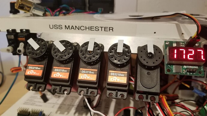

Also, I can drive my 270 degree servos with a servo driver to the full 270 degrees (476 to 2518 usec). But the getAngle can only drive my servos 214 degrees (900 to 2304 usec) using a 0 degree and 180 degree. I tried writing greater than 180 degrees (e.g. 200 degrees), but it doesn't move the servo any further.
In order to get the full 270 degrees, do I need to not use the getAngle commands, and instead, re-write the entire program using pulse length commands?
I have 270 degree servos and can drive them with a servo driver to the full 270 degrees (476 to 2518 usec). But the getAngle can only drive my servos 214 degrees (900 to 2304 usec) using a 0 degree and 180 degree. I tried writing greater than 180 degrees (e.g. 200 degrees), but it doesn't move the servo any further.
In order to get the full 270 degrees, do I need to not use the getAngle commands, and instead, re-write the entire program using pulse length commands? Which servo library supports servo commands through the entire 476 to 2518 usec range?
ServoInput has methods to set the range of the pulse width, so something like "DirIn.setRange(476, 2518) ;" should give you the extended limits for pulse width. The angle will still be reported in the range 0-180 degrees unless the library source code is patched.

Can you post some pictures of your project, in particular the power supply wiring?
Thanks.. Tom.. :grinning: :+1: :coffee: :australia:

I have a PMW meter that shows the servo jitter (fluctuations of usually 1-10 usecs, sometimes greater spikes) when the Mega is connected to the servos. When my servos are connected to just my receiver, the PWM meter shows no jitter.

Here's pictures of my wiring, test stand, etc.
