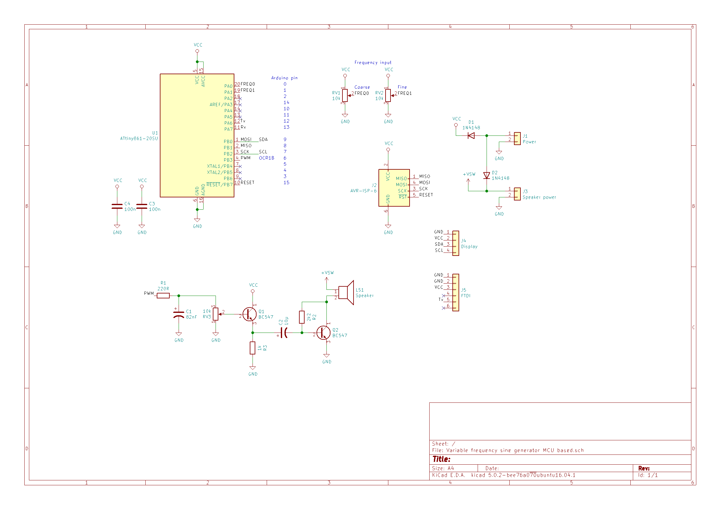

Here you go. Sine wave, adjustable through two pots (one for coarse, one for fine adjustment). Not every single frequency can be produced due to limitations in steps of the PWM. I built this one just for the fun of it a week or two ago.
Also note this method is specific for the ATtiny861a, which has a 8-bit 64 MHz timer for 250 kHz PWM frequency, allowing a rather decent sine wave at frequencies as high as 18 kHz, all the while keeping R1 and C1 small. I used a film cap for C1, as it's a kind of timing cap, ceramic should work as well.
The frequency as set can be shown on a 1602 display, which is assumed to have an I2C backpack.
The ATtiny85 also has such a high speed PWM available, but the ATmega328p as used in the Nano not. If you're OK with lower frequencies (up to 4-5 kHz) you should be able to get it to work but you need a proportionally larger value for C1, maybe also for R1.
Programming is done over ICSP; the FTDI header is only to break out a Tx signal for debugging.
