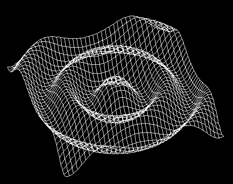

Also, what does this 3d sine wave look like?
Or...
If you want it to look like the last image, take a closer look at it, it has some useful equations for you. Take a look at the walls of the graph.
Thank you for the help!
So all i have to do is plug the equations into my code like this:
for(int x = 0; x < 7; x++){
    for(int y = 0; y < 7; y++){
        Z = sin(phase + sqrt(pow(map(x,0,7,-PI,PI),2) + pow(map(y,0,7,-PI,PI),2)));
        Z = round(map(Z,-1,1,0,7));
        setvoxel(x,y,Z);
My only question now is how would i vary the phase?

Here is a 2D example of what i'm tring to accomplish I would like to be able to vary the wave with the slider of a. The output should be between the black lines
Is there an easy way to do this?
Note: Thank you Ps991 for helping me on this project! :slight_smile:
here is a link for the wave

So, I got bored and decided that the best way to show you was to build my own led cube and program it for you, but I didn't want it to be a wussy cube, so I made it RGB to make it pop. Anyways checks to see if anybody believed that story
void sineWave3d(){
  byte y[8][8];
  float rads = 0;
  float t = 0;
  while(1){
    for(int x = 0; x < 8; x++){
      for(int z = 0; z < 8; z++){
        rads = ((float)sqrt((x-4)*(x-4) + (z-4)*(z-4)) / 4.) * 3 + t; //change that 3 to make it shrink/expand
        t += 0.005; //time, change this to make it speed up/slow down
        while(t > TWO_PI) //limit to 2PI, wrap around if overflow
          t -= TWO_PI;
        while(rads > TWO_PI) //limit to 2PI, wrap around if overflow
          rads -= TWO_PI;
        setLED(x, y[x][z] , z, 0, 0, 0); //clear old LED
        y[x][z] = 4 + sin(rads) * 3.999; //this is where the magic happens
        setLED(x, y[x][z], z, r, g, b);
    delay(50);
This works because the LED chosen to light up is based on the distance from the center, that distance is put into the sine function. Then a time variable is added, which causes an animation. If you want to make more sense of it, convert this code for yourself and simply comment "t += 0.005" which will make it all stand still.
THANK YOU SO MUCH! IT WORKED!
my last and final question is how would i alter the direction/axis of the sine wave? (its going side to side instead of up/down)
