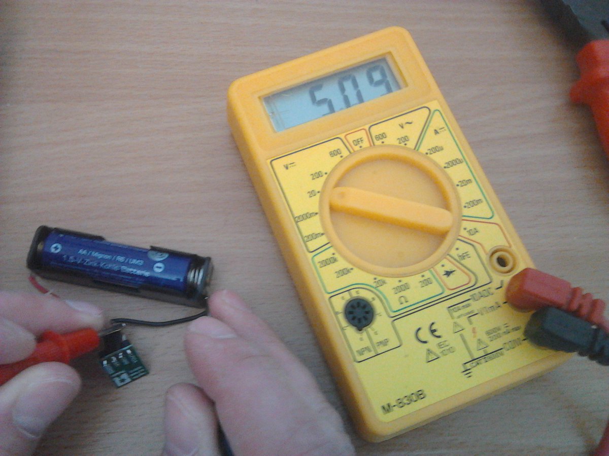

Yesterday I played with Arduino Uno and LCD Keypad Shield. Therefore I just connected a single 1.52V AA battery with U1V11F5 and that with Arduino Uno with shield, and all just worked!
The converter gives 5.09V:
I thought it might be interesting to know that you can power Arduino with 0.5V,
