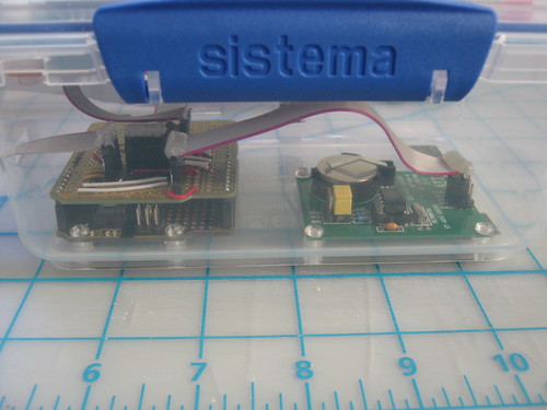

SleepyTimer - Interior by funnypolynomial, on Flickr
A tiny 3-axis accelerometer board sits in a small case at the end of a ribbon cable. It goes under my pillow.
SleepyTimer - Bedside by funnypolynomial, on Flickr
It’s connected to the main unit in a cheap plastic container (oh joy, tons of space!) with the Arduino, a graphics LCD, a DS1307 RTC, buttons etc.
