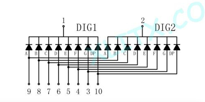

This is the 2 digit 7 segment cathode that i have. Are these pins in a standard position? Maybe they are different to the ones used in the woki simulation. All of the segments work so not faulty. Any thoughts?
Use your best common sense or a data sheet to eliminate all questions around what's hooked up to where.
I'm unaware of any standard position. You have a common anode or cathode, and you have eight pins for segments A..F and the decimal point.
Segment A..F is about the only standard here, the segments are labeled consistently.
Do you no longer experience inconsistent behaviour we've laid off against dodgy wiring or components or the breadboard?have you built your project in the wokwi? You can switch between common anode and common cathode when the display is select in the diagram pane.
Until in either simulation or real life you achieve solid functioning, it makes no sense to look at the software.
Start with the wokwi.At least there your problem will be 99.44 percent software.

Finally worked out the issue. The pins on my 7 segment are in different locations to the one in wokwi. I have a diagram that I use to make sure its connected to the right pins. Probably a rookie mistake. Just have to check the wiring as both leds flash when they change. Can anyone suggest how to add a reset button to bring back to zero. I now also need to change out the 2 buttons for ir sensors. Getting there. Cheers.

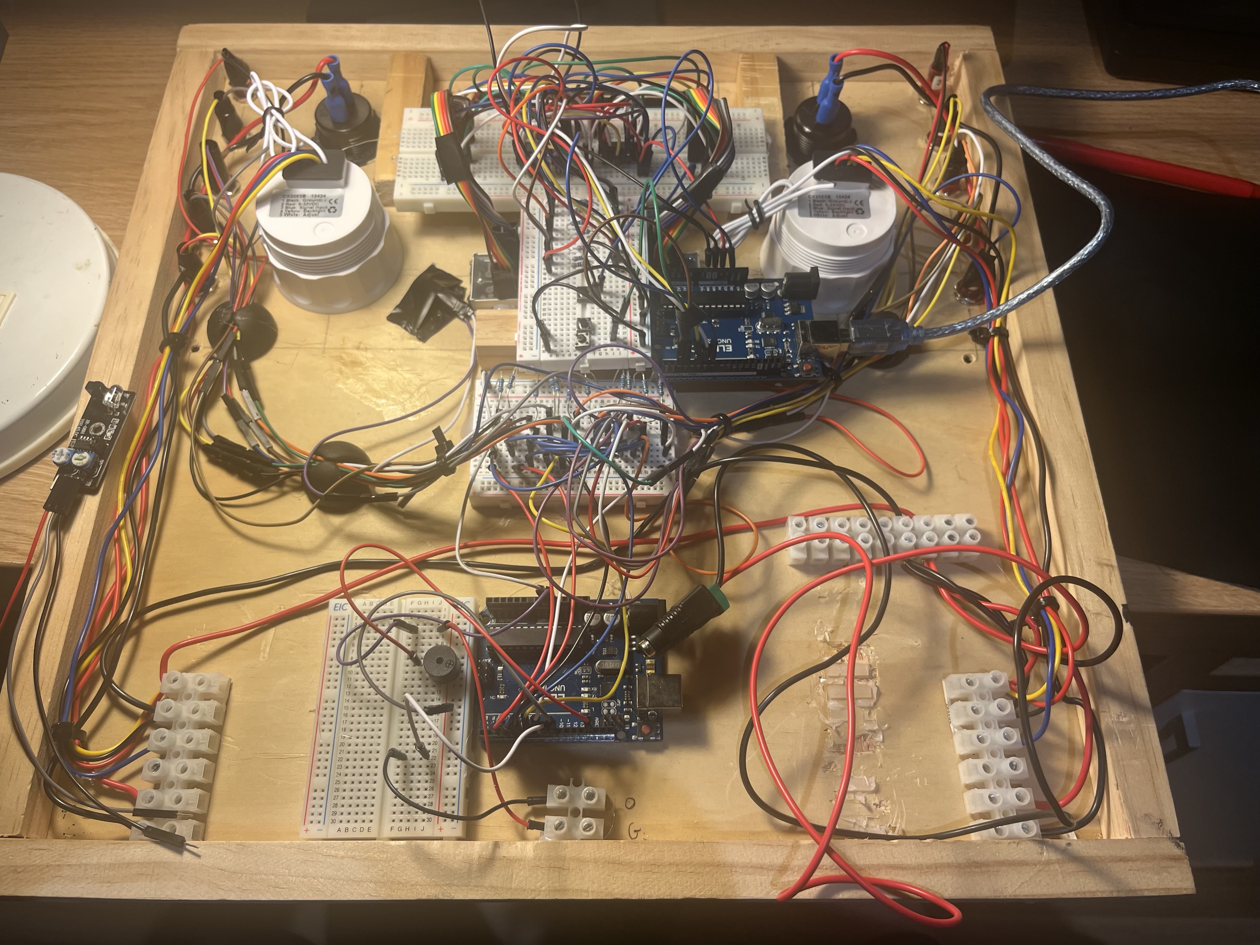

My last challenge is to replace the 2 buttons with 2 ir sensors. I have the sensors working but not integrated with the lap counters. Iāve tried putting in some code but best I can do is make the zeros blink not start counting. I donāt want to play around too much in case I lose what I have completed. Could I please have some help adding in the code to replace the button code with the sensor code. I will keep the reset button. Photo attached of the back. Itās getting a bit tight. My current sketch is at #27.
Cheers.
Write a simple test program for the sensor. It will produce the same signal as a button.
A button press yields low - high - low, or just the opposite.
A sensor yields low - high - low as a car passes, or just the opposite.
It's hard to know how to help, as you can see this is conceptually dead simple.
Post or say which post has your final button pressing code.
No it isn't. And don't you want to fix the button pressing sketch first, or are you hoping the sensor version won't need dealy()?
Post a sketch that does no more make an LED go on when a car is in front of a sensor.
Combinating the two parts, or switching to another kind of input for counting is all downhill. IMO you should be able to do it without help, but we here.
