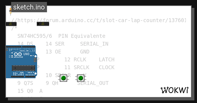

Hi all. I am looking at building a slot car counter using 2 infra red sensors, 2 dual seven segment displays(10 pins) and 2 of 74HC595 shift register modules and a uno r3. I want the counter to be able to have a reset button. I’m happy to research the code and circuit but I haven’t found a tutorial that uses exactly these items. My question is can I achieve what I need with the hardware I have.
Thanks.

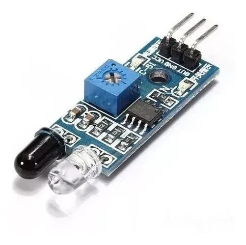

You could search for "exactly these items" and find the links in the previous post, or you could search on the individual items and learn about each device individually. After understanding how to write code for each device, you will understand how to use the devices together.
Just saying but this is totally doable without an Arduino. Without any programmation at all either
Try this code and "schematic".

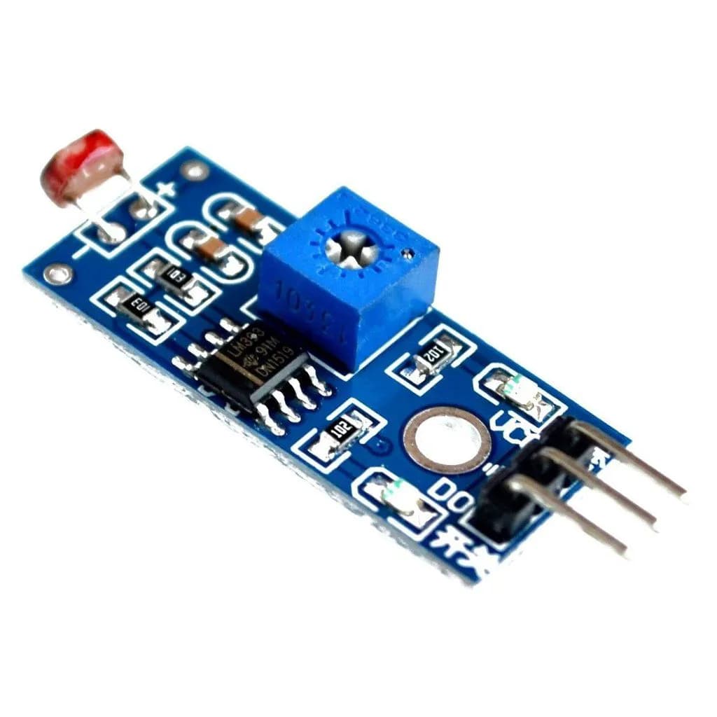

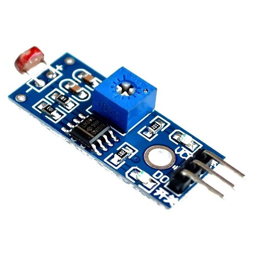

In your project, instead of buttons (which I used in the simulator due to lack of a suitable sensor), to increase the count use sensors.
These can be photodiodes or LDRs.
Sensors
and others more
Thank you so much. This looks perfect. I’ll give it a try. Cheers.
With 2 x 74HC595 you can use up to 8 digits. (4 dual displays, or 2 quad displays).
@ruilviana's code works well with pushbuttons and will appear to work as well when you simply replace the logical element with the sensor.
The handling of the sensor signal depends on the use of delay() and while the delay is "only" 30 milliseconds, it means that in practice there will be a time where the sketch is totally blind to input.
Will that mean two nearly simultaneous triggers will be miscounted?
You can wait and see, or you can replace the dependencies with logic that does not use delay.
Since you have been handed a solution, I can hand you the fix, I suggest fixing this before it ever is seen as a problem, just so you can forget about it and sleep better.

wokwi tested, I only changed one of the two nearly identical code blocks. If there were three channels, I would be telling you to write a function that handles any channel. I will post the code, as wowki may be less reliable or useful for some, and code posted here will not disappear for any reason other than the disappearance of these fora.
And now that the sensors can be handled without blocking, the blocking nature of the digit scan can be accelerated. Yes, it was only 4 milliseconds total, but it needn't be. I set it at 100 microseconds, for a total of just 0.4 milliseconds, which works in the wokwi but might have to be adjusted IRL.
Observe the digits blink when you operate the delay-based channel 2. That's the effect of not updated the display for 30 milliseconds.
Any of the deleterious effects of using delay can be easily observed by making those 30 ms delays something that seriously blocks - try 500 and it will be obvious why you don't want any delay anywhere ever. Here it is a necessary evil in the digit scanning; damages are mitigated by making that very shorter.

@alto777, I only used delay(30), because in the simulator I used buttons, (which generate bouncing).
If IR or LDR sensors are used, the delay is unnecessary, because they do not generate bouncing.
Thank you for the update. Would you mind giving me the link for the one with 2 buttons. I’ve started working on that one to see if I can get it working.
Cheers.
2 Buttons 4 Displays

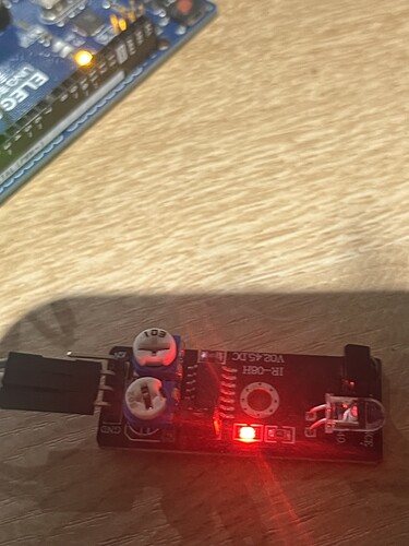

Do you have the sensors? Post a link to any details.
a7
Here are the sensors I have. I have set them to work using my finger going past the sensor. On the post I mentioned he out the sender and the receipt either side of the car and the counter worked as the car broke the beam. Sounds like a good option.
I’ve tried assembling the 2 button option about 5 times. Took a long time to check and double check correct connections, using two breadboards. Maybe a fault in a wire or breadboard. The leds work but not all segments. Very random. Any tricks to assembling the circuit.
Thanks.
If you have 4 pin buttons like those in the Wokwi simulator, the best way to wire them up is to use the 2 pins in the diagonal corners. Either diagonal is fine. That way, you can not get it wrong if the button happens to be rotated 90 degrees. If you don't use the diagonals there is a chance that you are using 2 pins that are always connected, regardless of the button state.
Thanks for that. Tried the diagonal option. Still no good. I’ll keep at it. Thanks.
