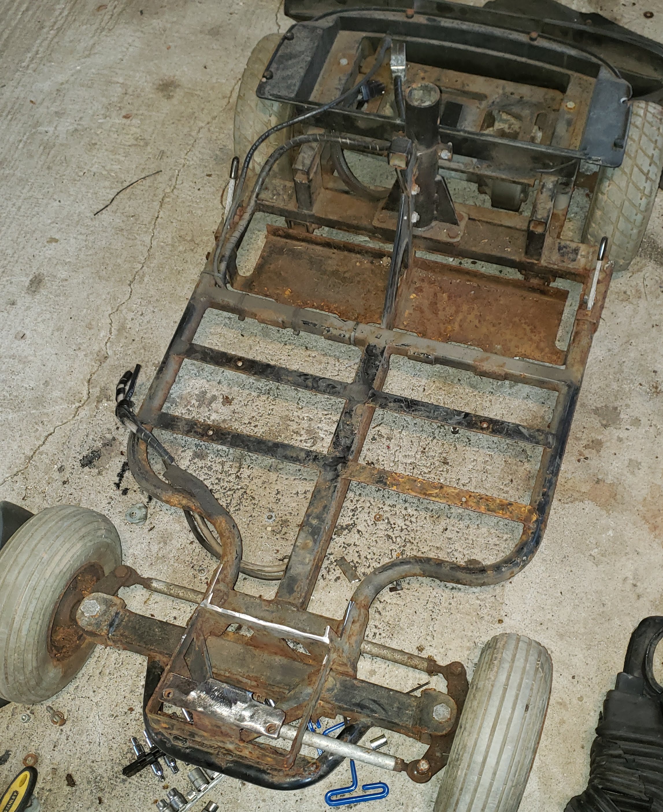

              I would look for a jazzy/powered wheelchair. Sometimes you can find one used for next to nothing. Through a friend of a friend I got a used jazzy for free that just needed batteries. Stripped all the unnecessary weight and used 2 4 cell lipo batteries wired in parallel in place of the lead acid batteries and it became a fun little cart to drive around.
Lipo batteries are a lot faster to charge and depending on the capacity keeps the fun going longer.

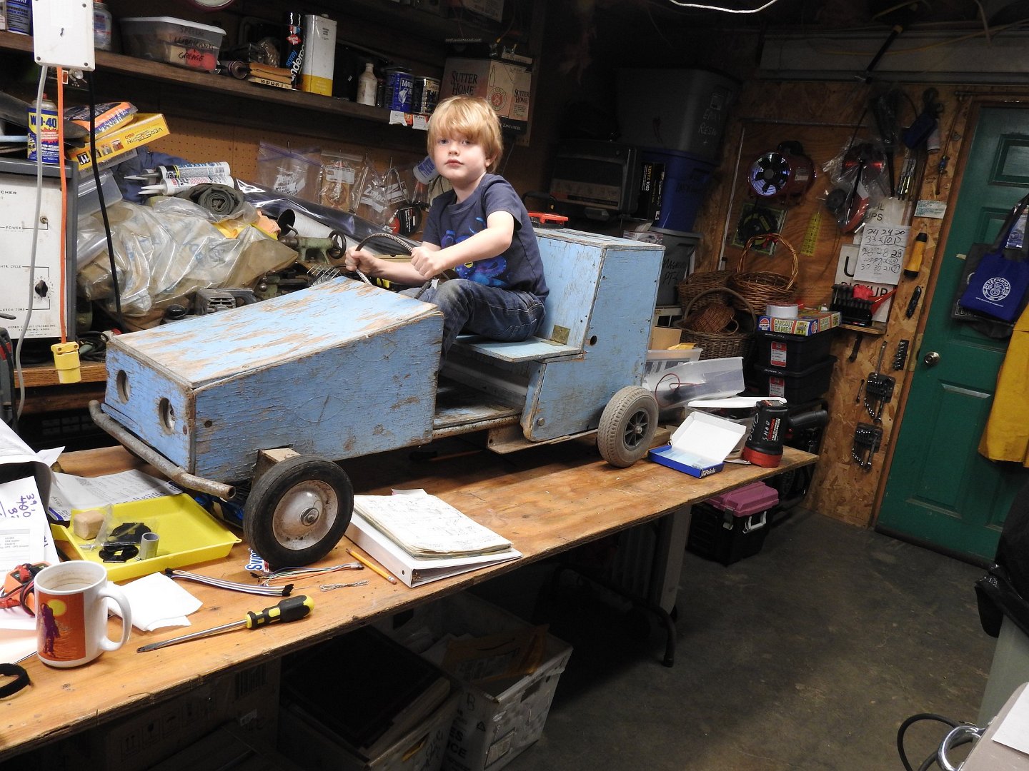

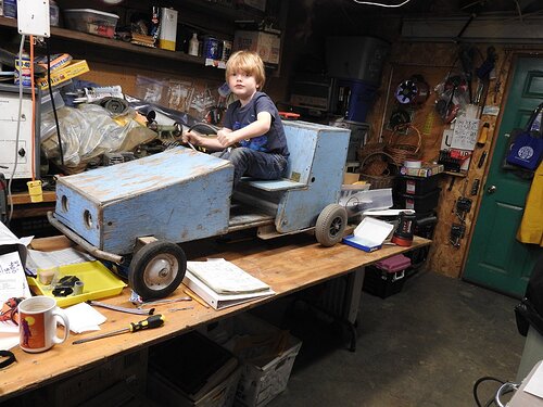

I have used an electric wheelchair / personal transporter motor and transaxle for several years in a small car that my Grandchildren (and even I) run, usually in the yard or sidewalk. It has a 24V DCmotor and I use two 12V 26AH gelcell batteries that have lasted for 5 years.
See the car and operation here:
This is the latest rebuild of this car; it originally had a 12V car battery and a 6V car generator for a motor.(In 1962 !).
The arduino controls a Pololu motor driver for speed and direction control. Also also the tail and backup lights.
The motor driver is a pololu-g2-high-power-motor-driver-18v25-24v21. It's small but works well;I have it heatsinked to a large aluminum plate.
I am working on a dashboard etc. consulting with my Test Driver. (Grandchild #14)..
Can't beat this kind of project for fun... ! !
