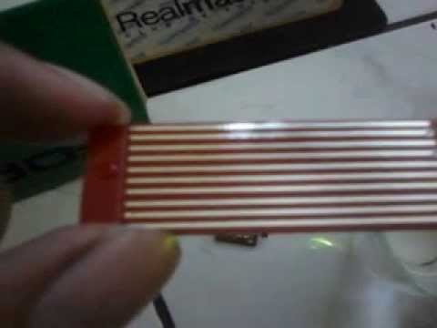

Asuming you dont want to drink the liquid you can control the amount of water into the bottle (or any recipient) by using a water level sensor :
So what you need ?
Basically a recipient with 2 oriffices, one connected to a source of liquid with a pump or elec valve, and another oriffice connected to a pump or elec valve. You control with the arduino or your favorite microcontroller when you want to push liquid from one oriffice or the other with the level sensor :
Valve or pump -----pipe liquid entrance --------- Bottle (fluid tank with level sensor) ------------ pipe liquid out ----------- valve or pump
