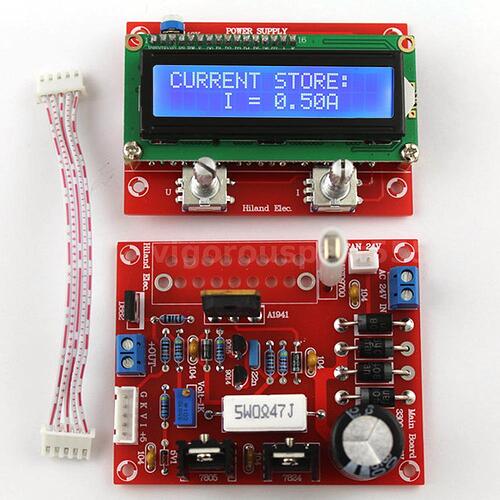

So, what I thought about doing is getting his "Tattoo Machine Power Supply"(that I will call TMPS for short from now on), turning it all the way up, sticking a shorted out MONO plug into the foot pedal socket and interfacing with it using an arduino. What do you guys think? Then I could do some really cool stuff like adding batteries so he can go wireless for a while, adding a wireless footpedal, smart lighting, emergency "bump" alarm, clock/timer, smart cooling fan, capasitive touch or touchscreen interface covered with glass to easily disinfect, completely get rid of knobs and selector dials, and so on...
So far I got a relay that runs the fan to go on and off with a temp sensor that I mocked up with a POT(actual sensor and fan on the way). I've also installed a KA05 shield made by velleman. It is an i/o shield, it has six relays that take up pins 8-13 and pins 2-7 has pull up resistors with leds on them as well as pins A0-A5.
I thought it was a good place to start. relay six will be for the fan and relay 5 I was going to use to switch the power to the TMPS on and off. Got that part working as well. But I found out about "SLEEP_MODE" and I've been trying to figure that one out. I have a topic about that going already. You can check it out here: Sleep Mode for Newbies? - Programming Questions - Arduino Forum
I"m planing on using a capasitive touch sensor for every button, I found one on ebay that is backlit and you can put behind thin glass.
I'm going to use a button for each channel or output. so that shouldn't be to hard to program but I still haven't been able to get only one to turn on at a time. Then I started to think about how I was going to control the voltage with touch buttons too, I haven't found a definitive answer yet but I have one option now. I have another topic going for that here: How to replace a potentiometer - General Electronics - Arduino Forum
Then I thought I could write something for a "BUMP" alarm. Basicaly, all of this is going to be housed on a cart that he already uses to house his power supply and a surgical tray that he sets his inks and machines on. So I thought I would add a speaker or something and a gyroscope and if someone accidentally bumps into the tray an alarm will go off and whatever tattoo machine was on would shut off until the alarm was reset by a push of a button.
Next big task I think will be trying to set up an i2c "pin extender". I realized that if I have an on/off button, "-"/"+" button for the voltage for each channel, and a selector button for each channel, Im at around 13 buttons, so I ordered this:http://www.ebay.com/itm/351608126297?_trksid=p2060353.m2749.l2648&ssPageName=STRK%3AMEBIDX%3AIT

I still haven't actually figured out all the power stuff out yet either. I'm going to need 5v to power the arduino and relays, 12v for the bigger relays and fan, 24v for the TMPS, and make all a UPS (uninterruptible power supply) controlled by the arduino so you can turn it on and off but still keep power just to the arduino to hold the voltage settings for the different channels.
