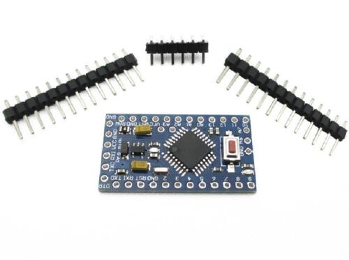

this is a small perimeter sensor type project that counts on bar graph how many times the beam has been broken..
when laser is not recognized, int graphLed increases by 1 and lights the next LED in the bar graph.
question is about software reset. I want to push switch and reset counter. I use pin 12 that I jump to reset pin on the board. If I declare pin type before setting it high or low, it will go low FIRST and get forever loop.
I read somewhere that you have to set PIN to HIGH prior to declaring type. I make pin HIGH prior to declaring a type which seems to work.
so when momentary switch (switchpin) is pressed, it sets switchpin 13 = 1 which sets pin 12 to LOW and then system restarts.
problem is when button is pressed it appears to go into a forever loop.
I have to unplug and plug back in to get to work again.
why would it work fine when first plugged in, but not work after a restart?
any, simple way around this?
can I wire the momentary switch (3 conductors, vcc, gnd, signal) somehow directly to the reset switch and not have a pin set another pin?
I just dont know what to do next to fix this.
I really want to use this particular switch.. they are cheap and work well.
thanks in advance!
Pete

Here are the components I used:
arduino pro mini
laser receiver module
10 Segment Digital Red LED Bar Graph

The reset pin on the Arduino is usually Held high by a pull-up resistor. Pulling it low (connecting it to ground) via the Hardware Switch should work perfectly. That's how the on-board reset Switch on the Arduino does it.
Why are you using the hardware reset from software?
Seems a bit unusual.
Dwight
Why do you think that you need to reset your Arduino? You can simply reset the counter when you press the button.
if(digitalRead(switchPin) == HIGH)
  graphLed = 2;
And as you already have something to clear the display as well
  if (graphLed == 12 || digitalREad(switchPin) == HIGH)

Note: I hope you have a pull-down resitor connected to the switchPin. If not, the input is floting and cn randomly affect the behaviour of your application.
I guess I attempted to use the hardware reset through software because of my inexperience with Arduino..
Thanks to sterretje for a simple quick solution.
if I took my head out of the box for a minute, I may have seen it.
Works GREAT!!
Thanks.
