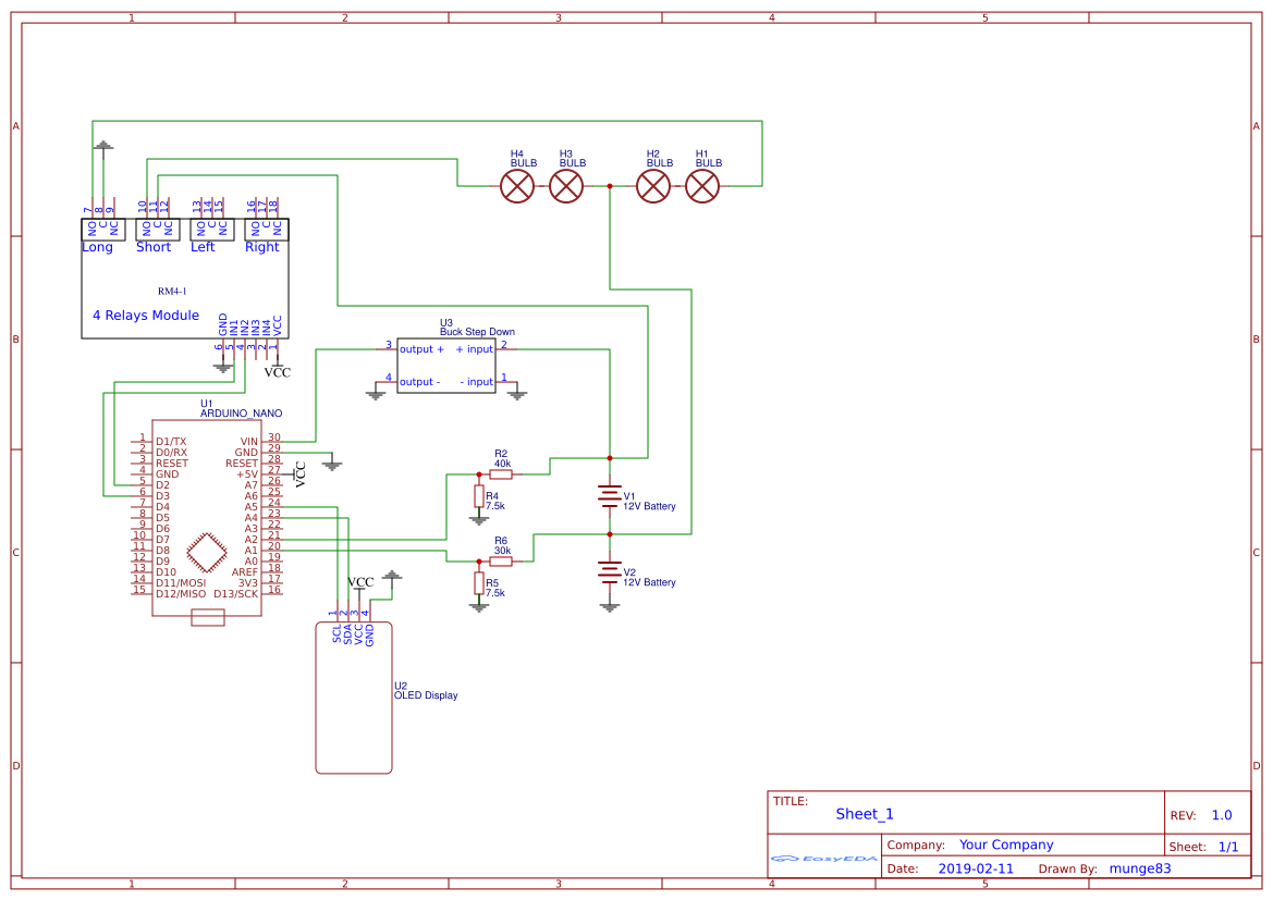

Um tom, is that an Arduino? Are you running 24v direct into A1?
Daz
Not my diagram, and the OP has mentioned he/she will be using potential dividers on each of the analog inputs.
Tom... :slight_smile:

@toxsickcity
I'm understanding your struggle.
I'm hawing the same issue with my 24V solar sistem and looking for the solution. I found of the shelf devices that do exactly what I need but they are so expensive that you can build your one for the 1/10 of the price.
I'm also understand that my batteries are on the end of there life, but this is learning proces for me and I want to convince myself that I'm wrong.
So this is what I did:
List of parts
1x Arduino Nano V3.0 - https://goo.gl/NkqSv8
1x Step Down Buck Converter - https://goo.gl/J2JNVa
1x 2-Channel Relay Module Shield - https://goo.gl/oPUoL1
1x 0.96 inch 128X64 OLED Display Module - https://goo.gl/Hunx2E
4x Halogen G4 12V - https://goo.gl/qwpbem
-- I'm using pre made voltage sensors but you can build then with these resistors;
2x 30k ohm ressistor
1x 10k ohm ressistor
2x 7.5k ohm ressistor
I'm not going to post the schematics at the time because I don't have time to do them now.
This is the code and picture of my device.
Here is the schematics , and I updated the code.

The device draws 20mA of current when idelig and about 80mA when relay kick in.
