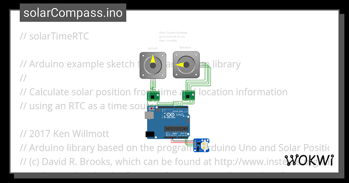

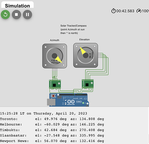

ETA: here's a sim with steppers:
// solarTimeRTC
// Arduino example sketch for SolarPosition library
// Calculate solar position from time and location information
// using an RTC as a time source.
// 2017 Ken Willmott
// Arduino library based on the program "Arduino Uno and Solar Position Calculations"
// (c) David R. Brooks, which can be found at http://www.instesre.org/ArduinoDocuments.htm
// and issued under the Creative Commons Attribution-NonCommercial-NoDerivatives 4.0 International License:
// https://creativecommons.org/licenses/by-nc-nd/4.0/
// Simulation at https://wokwi.com/projects/362461186756144129
// Based on https://wokwi.com/projects/362382128060882945
// written for https://forum.arduino.cc/t/solar-position-library-for-solar-trackers/1116831/5

    azimuthStepper.moveTo(stepsPerRevolution * ( -NewportNews.getSolarAzimuth()) / 360.0);
    elevationStepper.moveTo(stepsPerRevolution * ( -NewportNews.getSolarElevation()) / 360.0);
// Print a solar position to serial
void printSolarPosition(SolarPosition_t pos, int numDigits)
  Serial.print(F("el: "));
  Serial.print(pos.elevation, numDigits);
  Serial.print(F(" deg\t"));
  Serial.print(F("az: "));
  Serial.print(pos.azimuth, numDigits);
  Serial.println(F(" deg"));

Didn't you post some final code?
Hi! Sorry for the late reply. I did post a code using the SolarPosition Library. However, I am having trouble syncing the time and date accurately. I found another: Solar Calculator and this library works the easiest for me. Currently, I am working on positioning the motors and also on how I will be testing the Solar tracker in comparison to fixed one (Do I need a current and voltage sensors for this or is there a simple and easy way to identify the output of the panels?). Additionally, I considered creating an app from MIT APP INVENTOR for smart monitoring, the data was transmitted using an HC-05 Bluetooth module.
Btw, Thanks to the info you have given, really helps a lot!
