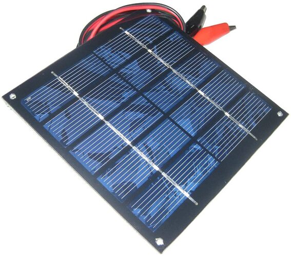

Hello. I am building an Arduino robot controlled by an Arduino Mega. I wish to make it solar powered.
I plan to use a solar panel like this one:

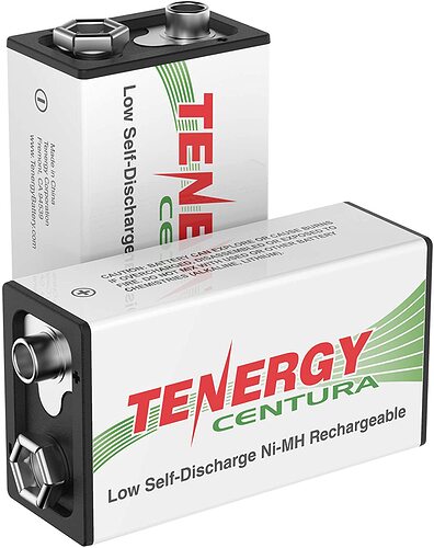

The solar panel will charge a 9V battery such as this:
The 9V battery will be plugged in to the Arduino Mega, and power it. When the Arduino Mega detects the battery is almost empty, it stops what it is doing and allows the solar panel to recharge the battery.
Will these parts I linked to work in a system like this? How would the Arduino Mega detect if the power is low?
Don't plan on powering any motors with that 9V battery, and expect at best about 1 hour running just the Mega.
A 5V solar panel will not charge a 9V battery.
You really need to learn something about power considerations. I suggest to spend some time on the web doing research. A good place to start is here How to Build a Robot Tutorials - Society of Robots
That solar panel is rated for 1.25 Watts in full sun. The battery holds 9V * 0.2Ah = 1.8 Wh so it would take over an hour to charge your battery in full sun with no losses in the charger circuitry. Figure about 100mA for the Arduino alone and each charge will last about two hours.
If you add a motor or two so your robot can move... figure another Amp or two for those and you will get about 6 minutes of motion for each two hours of charging.
I think you will need to consider your power requirements in more detail before you pick battery and charger components.

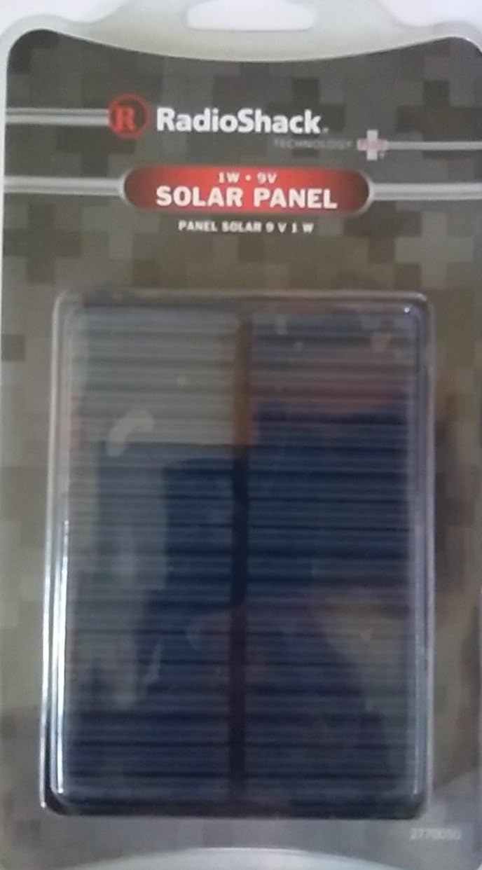

This solar panel says its 9v:
Maybe two of them wired in series would do the trick...

That voltage rating is open circuit, full Florida sunlight. Any load, like a charge controller will quickly reduce that voltage. Yes, two on series and a charge controller will cut the charge time that Johnwasser gave you in half. Still won't run motors.
