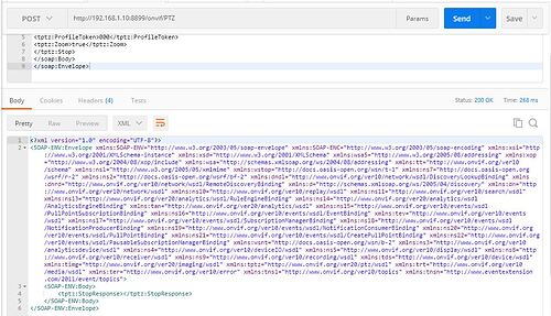

I have an NVT IP Cam. On the PC i'am testing onvif soap traces on POSTMAN for the controling PTZ actions. Traces works perfectly. But i wanted to control it from arduino, i have ENC28j60 ethernet module, trying to post this soap request by modifiying twitter example skecth but not working, what am i doing wrong?
POSTMAN Request
Request Response

I solved the problem by making some changes...
Removed these lines
if (!ether.dnsLookup(website))
    Serial.println(F("DNS failed"));
  ether.printIp("SRV: ", ether.hisip);
and added these..
  ether.copyIp(ether.hisip, hisip);
  ether.hisport = 8899;
Also changed stash preparing lines like this...
  Stash::prepare(PSTR("POST http://$F HTTP/1.0" "\r\n"
    "Host: $F:8899" "\r\n"
    "Content-Type: application/soap+xml; charset=utf-8"  "\r\n"
    "Content-Length: $D" "\r\n"
    "\r\n"
    "$H"),
  website, website, stash_size, sd);
i hope it will help some one needed to...
