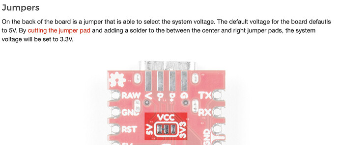

Now here's my problem. When I connect the device with the USB-C port to either my MacBook Pro or my Windows desktop computer, the device is not recognized. On macOS, I just don't see the COM port listed. On Windows, the OS warns me that the "USB device is not recognized" and is malfunctioning.
I initially put my finger on the crystal because avrdude reports it "OFF", so I checked it with my cheap BitScope and, although the sampling rate is not high enough by the looks of it, it has a periodicity of 4MHz which could just be what I see with my sampling rate, the real rate being 16MHz supposedly (I captured every 4th point in the signal I think).
Also, since I was able to flash the bootloader, I think it would indicate that the crystal is working as intended.
I would love some help to troubleshoot this, as I really don't have enough experience to do it on my own.
THANKS! :slight_smile:
Here's a picture of the assembled board. Please also note I tried the Arduino Leonardo bootloader but the result was the same.

USB data line series resistance (R2, R3) is too high...
5.1K ohm is placed, but it should be between 22 to 47 ohm.
Also, ATmega32U4 is not guaranteed to operate at 16MHz at 3.3V VCC.
It works with a good at many case, but it can cause unexpected glitches.
Well, Pro Micro also operates at 16MHz is only at 5V version, and 3.3V version at 8MHz only.
Please check attached the excerpt of the datasheet.

  • switch the data lines resistors to 22-47R (shouldn't have blindly followed the sparkfun schematic)
  • if that doesn't solve it, source a 8MHz crystal and corresponding caps (note the sparkfun USB-C model has a jumper to switch from 5V to 3.3V and only has a 16MHz crystal)
  • if that fails, check what linux has to say about it.
Will report when I have tried some of these :slight_smile:
krizzli:
Of course! You have the right to "run 32U4 at 8MHz using internal oscillator".
In that case, 16MHz crystal is useless component. It's wasted... :stuck_out_tongue:
Well...!
In addition, an 8MHz system clock can be obtained from a 16MHz crystal using a prescaler.
Yes! The crystal is still alive! :wink:

SUCCESS! Massive thanks to chrisknightley, you spotted the correct mistake of mine. I switched the resistors on the USB data lines and everything works as expected! I'm gonna keep an eye out from problems relating to 16MHz but for now my blink program works :smiley:
