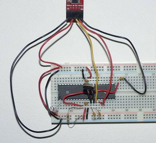

I've successfully built a standalone breadboard version of an ATmega 1284p via Manicbug's helpful post:
link here
I can upload a simple Blink sketch which toggles an LED fine, but when I try some other example programs that are larger they compile fine but uploading fails. Upon hitting 'upload' the Rx Tx LEDs on the FTDI Basic rapidly blink for approx 2-3 secs then upload fails with a return message of:
avrdude: stk500_paged_write(): (a) protocol error, expect=0x14, resp=0x62
Or alternatively:
I've checked the wiring connections, tried powering the 1284p via a separate 5v and anything else I could think of and searched a bunch of posts on this, but not figured it out.
Could it be related to a time-out issue upon auto reset via the DTR pin on the FTDI Basic? It seems odd that it accepts Blink just fine, then without adjusting anything will not accept more complex sketches.
I've a 10K pull-up resistor on the RST pin per Manicbug's setup & can upload Blink with or without it connected, but no change for other sketches...
Here's my setup:
Arduino 1.6.5 on Mac OS X 10.11,
In IDE - Selected Board: MightyCore ATmega1284p
Correct USB port connected to: FTDI Basic from Sparkfun (also tried newer Module -same result)
Wiring
FTDI Basic <----> 1284p
DTR line goes to RST on 1284p (physical pin 9 ) via 0.1 uF Cap,
RX ---- TX (D9, physical pin 15 )
TX ---- RX (D8, physical pin 14 )
5v ---- 5v (via breadboard rails to all appropriate pins)
Gnd ---- Gnd (via breadboard rails to all appropriate pins)
Any help greatly appreciated, thanks!

Do you have decoupling caps (Vcc to ground) on all Vcc pins on the 1284p? 0.1uf ceramic, right next to the chip
Can you post the full output of the upload with verbose upload enabled?

Yes, I've decoupling caps between the Vcc and Gnd pairs on either side of the breadboard 1284p and the caps are as close to the pin legs as possible (same goes for the external crystal - as close as possible).

What kind of version of MightyCore are you using? I've fixed a nasty ATmega1284 related bug last week that messed up the clock speed. The new version works fine on my development board. It would also be nice if you posted a picture of your setup :slight_smile:

Hi Hansibull, For MightyCore I'm using the 1.0.0 version (per the Boards Manager) which I added into the preferences from here:
https://mcudude.github.io/MightyCore/package_MCUdude_MightyCore_index.json
I just tried updating to 1.0.3-r1 and the Blink which previously uploaded OK, failed (the output is attached), so I rolled it back to 1.0.0 and Blink does upload again.

There is a 64k limit in (many of) the communications protocol between the PC and the "programmer", because the "start address" for each block to be programmed is sent as two bytes. Whether that is 64k bytes or 64k words depends on which protocol you are using, and the USBtinyISP uses a different protocol from "Arduino as ISP", so it could have a different limit.
The original problem sounds a lot like the "RESETS occur when uploading code on UART0" that has been reported off and on with the m1284. This was supposed to be mostly fixed by using fuse settings for "full swing" crystal oscillator rather than the "low power" crystal oscillator. Can you confirm that you're using that fuse setting?
For a standalone 1284, you might consider using UART1 for bootloading instead.
I changed the standard fuse setting to full swing for all external oscillators in early January (IIRC). If richCharthew bootloaded his Atmega1284 using MightyCore v1.0.0 it doesn't got the full swing setting.

Like mentioned earlier in this post, there are some issues when burning the bootloader on chips with larger flash memory when using the USBtinyISP. Please try both ISP programmers and give us an update on how it went :slight_smile:
hansibull:
Success!
Perseverance pays off, thanks everyone for your suggestions and advice, esp Hansibull, very much appreciated.
@Hansibull, I'm pretty sure you were correct - I think it was the existing bootloader code on the 1284p that was causing problems.
Also the USBtinyISP threw an error after bootloading, but thanks to you mentioning it, I tried uploading a few large sketches anyway with a snippet of LED blink code in the setup() to visually confirm that they uploaded correctly without having to wire up the CC3000 = seems all systems are go.

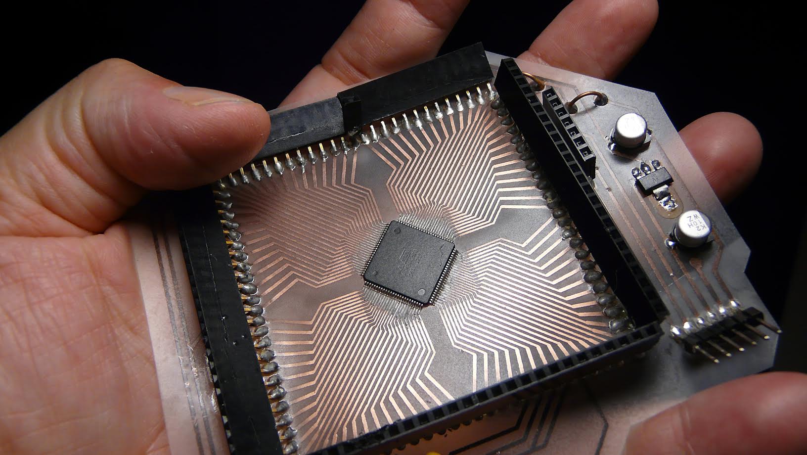

Looking forward to building with the 1284p - I tried to build with the 2560, but could never get the bootloader onto my homemade chip - possibly the dimensions are a wee bit too small on the pins to solder successfully, although I did give it a go last year.. check out the attached pic :slight_smile:
Rich.
Wow! That's how it should be done :slight_smile: Is the Atmega2560 board completely dead, or do you just get an error message when burning the bootloader? I don't see any bypass capacitors close to the chip. This often causes stability problems.
I'm planning to build an ATmega64/128 development board to test my other Arduino core. The breakout module itself was sent to production on Tuesday. These microcontrollers are a bit easier to solder than the 1280/2560, and they cost next to nothing at eBay and Aliexpress
