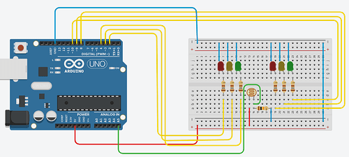

for a homework assignment i am making a stoplight junction.
It will have 2 separate cycles [Day - Nighttime].
While at daytime the sketch will do a full cycle every 2 minutes.
[ In the test sketch as it is right now this is shorter. ]
While at night time the car lane will be showing green light,
until a biker shows up on the bicycle lane.
The LDR sensor will detect as well the day or night time,
and the faint light from bicycles.
Once a biker shows up the cycle gets activated.
But to make sure the next biker will not immediately trigger
the next cycle, I want to implement a timeout, so the cars
have time to pass also. After this, when no new bikers,
the lights go back to the default night time cycle as long it is night.
The problem: I have followed the steps of a few tutorials that
let me set up 2 variables, 1 for the start value and 1 for the current milliseconds.
Then they sell me to use if (curMillis - preMillis > interval) {} else {}
But then nothing happens. Bikers cycle does not even gets triggered.
Of cause if (curMillis - preMillis < interval) {} else {}
does gets triggered, but then it will not use the timeout and straightly activates
the bike cycle again if a new biker is present.
What do i need to do in order to get this timeout function to work ?
Many thanks in advance for the help. Much appreciated!.
**The code is on Paste-bin as it is big **Stoplight - Pastebin.com
This is the sketch incl simulator: Circuit design Traffic Light Switch (Day / Night Senario) | Tinkercad
This is how the setup looks:
Not an expert but, I don't think this -
 return loop();
is a good idea.
But I could be wrong.

Apart from the function being void, and thus not able to return anything in the first place, even if the function wasn't void, could the return even be a function name?
return foo();
//as distinct from
return foo;
Many thanks all, i will try the advice you all gave me.
Delta_G:
 if (sState > threshold) {
return daylightRoutine();
    return nightlightRoutine();
Lose the return statements. The "void" in front of the definition for the loop function literally means that it returns nothing. So having return statements in a function like that is totally missing the point.
return loop();
Again here. I think you have a fundamental misunderstanding of what return does. You just need to delete this line entirely. Since your function was called from loop, it will return to loop once it finishes. That's not what the return statement does. That's for returning values from functions.
The only language knowledge i have thus far is Javascript.
So at some times i can get a little confused to some little things that are different here.
I am use to return all functions and ending of code blocks.
I know it returns to loop automatically, just felt good to physically return it.
I shell try to dis-learn that behavior here haha.
I understand now the void problem. I am returning a value that later needs to be checked.
and as i am returning nothing, nothing will happen.
I will try out your advice in a moment and update the topic.
Many thanks for the time guys !
Okey i think i have something now that works good.
I can start edit my code and implement it.
If you guys still see anything wrong with it then
let me know what i should change and why.
Many thanks for the help.

Haha okey, seems i did not need a timed timeout function at all.
I was simply able to do it with a simple switch and a delay for this specific sketch.
Well at least learned how to use functions now in Arduino :slight_smile:
Cleaned it up and made it a but more modular.
