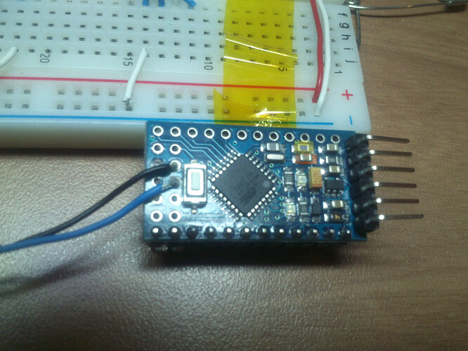

Thanks, I'm useing 1.5.6 version IDE, I will try the 1.05.
pls help me, I have same "mini pro"
same issue, I tryed everything you told me but it doest not work for me
I always get this messidge
this messidge I give power to mini from uno programmer
avrdude: Yikes! Invalid device signature.
Double check connections and try again, or use -F to override
this check.
this messigge I get when I give him external power 5V
avrdude: stk500_program_enable(): protocol error, expect=0x14, resp=0x50
avrdude: initialization failed, rc=-1
this check.
avrdude: stk500_disable(): protocol error, expect=0x14, resp=0x51

I finally fixed it, I am so happy right now :smiley:
I solder up all connections so I am 100% sure that maybe something isn't connected
this time I followed solution from sparkfun forum
https://forum.sparkfun.com/viewtopic.php?f=32&t=27960
  1. Connect the Arduino Uno via USB to the PC
  2. Open the Arduino IDE
  3. Arduino IDE > Tools > Serial Port > (Select port of your Arduino UNO)
  4. Arduino IDE > File > Examples > ArduinoISP
  5. Upload the sketch. once complete your Arduino Uno is now programmed to be an ISP programmer.
  6. Power the Uno off and wire the Uno to the Arduino Pro Mini in the following fashion:
Uno---------------Pro Mini
5V(VCC)-----------------------VCC
GND------------------------GND
Digital Pin 11(MOSI)----pin 11 (MOSI)
Digital Pin 12(MISO)----pin 12 (MISO)
Digital Pin 13(SCK)-----pin 13 (SCK)
Digital Pin 10----------RST
  1. Power on the Uno
  2. Arduino IDE > Tools > Board > Arduino Pro or Pro Mini (5V, 16MHz) w/ ATmega328
  3. Arduino IDE > Tools > Programmer > Arduino as ISP (this option I had checked even in step 5 while uploading IPS sketch, because of previous attempts)
  4. Arduino IDE > Tools > Burn Bootloader
also I want to give some more info, on lots of examples on internet and youtube, I saw lots of ppl removing their ATmega chip from their arduino uno to program pro mini... That looked kind a silly to me, and I manage to found solution.
http://proto-pic.com/Datasheets/pro-mini/UNO_PROMINI.pdf
Step 1.
Connect jumpers as follows
Arduino UNO --> pro mini
RESET -- GND
RX --> RXD
TX --> TXD
VCC --> VCC
GND --> GND
and yes RX goes to RX and TX to TX for sure :slight_smile:
Step 2.
Plug the arduino into the USB lead as normal
Step 3.
Step 4.
Load/Type your sketch into the IDE
Step 5.
Click the Upload Icon or Arduino IDE > File > Upload
Step 6.
When the sketch size show in the debug panel (The bottom of the IDE)
Tap the reset button on the Pro Mini - This starts the bootloader.
if you get error "avrdude: stk500_getsync(): not in sync: resp=0x00"
practice your timing with clicking reset button after seeing "Binary sketch size: 3.772 bytes (of a 30.720 byte maximum)"
If there are any error messages - Double check the wiring, The most common cause of error is
connecting the Rx and Tx lines back to front.
I hope it will help someone,
anyway those little pro minis are fantastic :smiley:

I tried to burn the bootloader again. same error message.
one more thing I noted is that, the LED on my pro mini never blink.
not sure it is good news or bad.
3.3v-----------------------VCC
Arduino:nightly (Windows 8), ??"Arduino Pro or Pro Mini, ATmega328 (5V, 16 MHz)"

I got two of these DSWY ROBOT boards and I have a problem that was previously mentioned. However, I lost track of who answered what, so I need some help.
These are the first boards I got along with a Mega 2560. I programmed the Mega as an ISP using the example code. When it is connected to the computer LED 9 pulses (I think that is supposed to be the "heartbeat" so it is working. I connected my mini as follows.
Mega------->Mini
53----------->reset
52----------->13
51------------>11
50----------->12
I also tried connecting the corresponding ICSP pins to no avail. The error is "Yikes! Invalid device signature." The Mini started with the slow blink, but after I tried to bootload, the LED does not light up.
Any help would be greatly appreciated. Thank you in advance.

Hello folks,
After hearing about some local folks having trouble with this board, I bought one to investigate. I wrote about it in length in my Hebrew blog - but maybe the results would be of interest to readers here too.
It turned out that the ATmega328's clock fuses were set to the (factory default?) internal oscillator (which is 8MHz) with a by-8 division; hence the 16-second blink. When I reprogrammed the fuses to the proper values (for the external crystal) the board died, because apparently the crystal itself was defunct, so now the MCU had no clock and no ability to communicate with anything.
I applied an temporary external signal, rather brutally, to the MCU's XTAL1 pin and managed to revive it; I programmed the fuses back to the internal oscillator without the division, so basically I have now a working 8MHz-Pro-Mini clone.
Important note: Trying to burn a bootloader using the Arduino IDE on a board with this specific problem is a bad idea, because apparently the burning process includes resetting of the clock fuses to the external crystal.

Hello,
I also encountered these problematic Pro Minis (through a friend who bought them and didn't manage to use them).
I tried to burn a new bootloader through a working Pro Mini with no luck.
I went with igendel and avr_fred assumption of the Capacitors.
and I switched the capacitors in the Picture, and then I succeded in burning a new bootloader.
Now I can load sketches through a regular USB2Serial cable (though the Reset still dosn't work well and I need to reset the Pro Mini manually with the reset button).
Hope this helps someone
to netanelf or anybody else involved: I 'm still puzzled.
A) The picture posted is before or after caps swap?
B) Which caps are for the xtal and should be equal?
Please try to repost the image and giving clear annotation.
Thanks in advance
I will try to clarify,
Here is the image of the Arduino Pro Mini I had (before any changes)
as you can see (i verified with a multimeter)
That C3 and C4 are the capacitors that go to XTAL1 and XTAL2, unfortunately, they are not the same size (-:
I think I found why the reset isn't working for me.
as you can see C1 that is connected to AREF on the ATmega should go to GND and not to RESET.
here is the Pro Mini's Schematics (from sparkfun - eagle library):
I think that:
  • C1 and C4 should be swapped (C4 should be exactly in the size of C3)
  • I didn't try this yet, but i suspect that C1 should be disconnected from the RESET pin and connected to GND instead
UPDATE
So i tried what I said and seperated C1 from C2 and now the reset works fine.
after swapping the capacitors, seperating C1 from C2 and connecting C2 back to the RESET pin my board looks like this:
Thanks to all,
I saved my Dswy_Robot this way..
