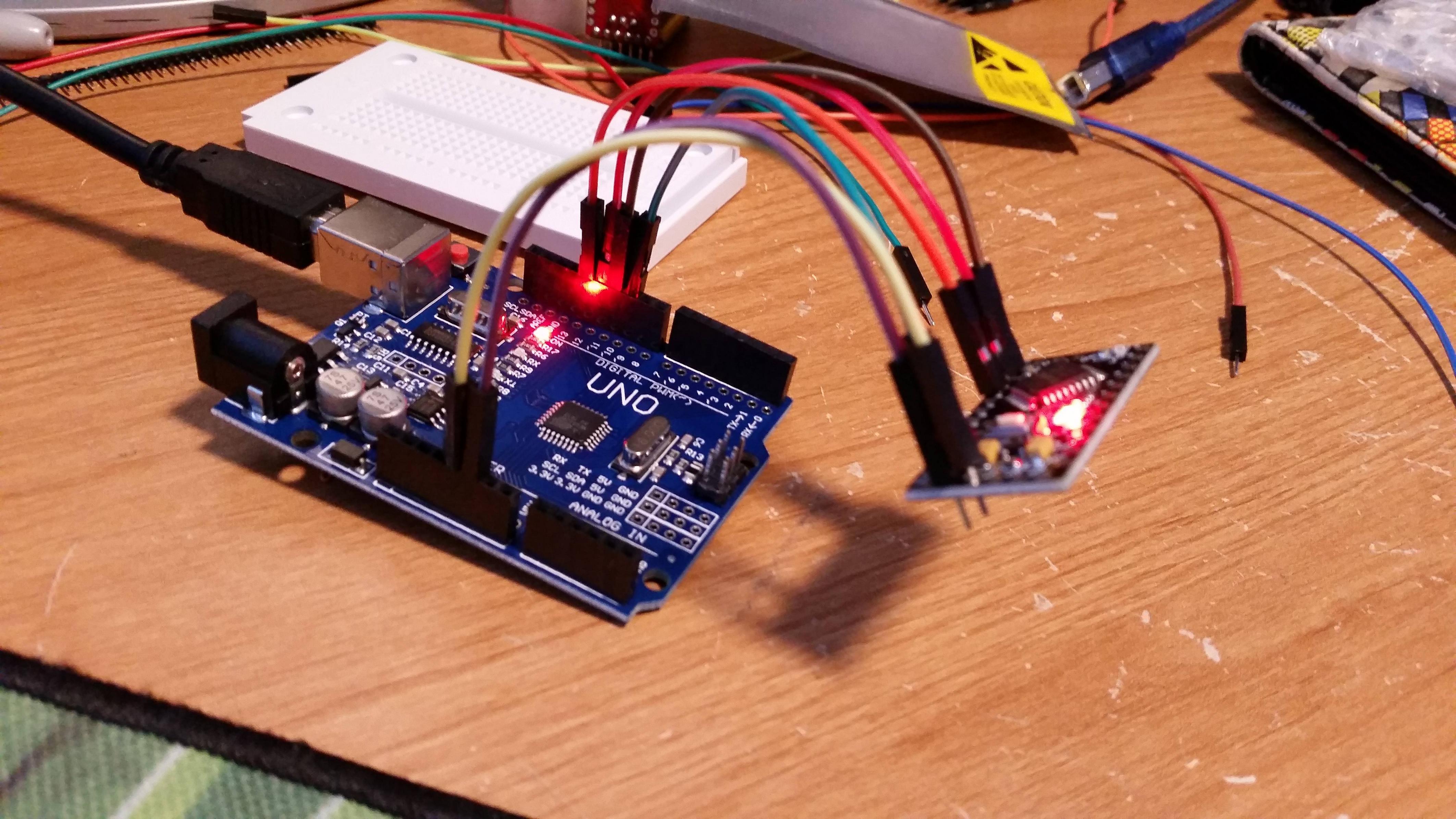

ok so i have a problem i can no longer burn bootloaders or sketches to my pro minis with my unos
i make ps1 modchips with the pro minis and iv done many so i know my wiring is ok i know my pro minis are ok as i can still program them with serial usb
ive tested with two unos same results
im at a loss...
here is my log dump via ISP

i know this is typical of bad wiring or bad chip but iv done 100's of successful uploads then one day it stopped working...
