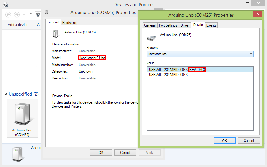

I successfully modified the board and confirmed that the board now appears as per the wiki page ...

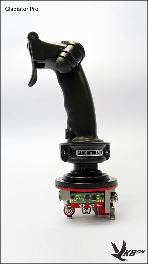

Yah, the uni-joints. The 2 I saw used Volvo drive shaft universal joints.
They had magnets on the shaft ends and linear Hall sensors placed over them.
Yes I've seen a couple of examples of those, pretty nice. I think I saw a nice example of replica Spitfire control column using a uni-joint.
It's quite common for custom builders to use hall sensors, they provide much more reliable inputs to the sim than pots, but they allow you more freedom in how the gimbal "feels" in the sim.
The VKB gimbal I'm using uses hall sensors, just need to work out the wiring.
