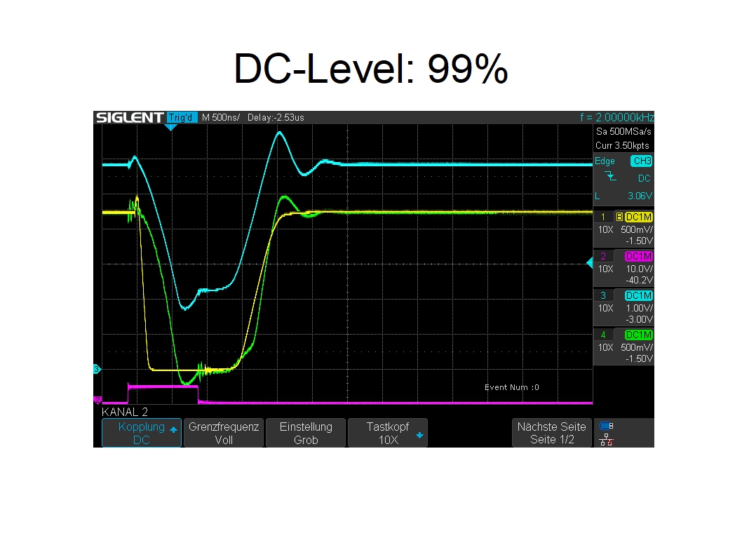

Result is below:
  • PURPLE: Signal to turn current OFF (output function generator)
  • YELLOW: Input to voltage controlled current source (CW_Ref) in circuit shown in #1. As such, it goes down to zero when the signal to turn current off gets HIGH. I.e. acts as reference value
  • GREEN: Measured current across shunt resistor R42. Shall match with yellow one. I.e. acts as acutal value. GREEN shall follow YELLOW.
  • BLUE: output of driving OpAmp U16A.

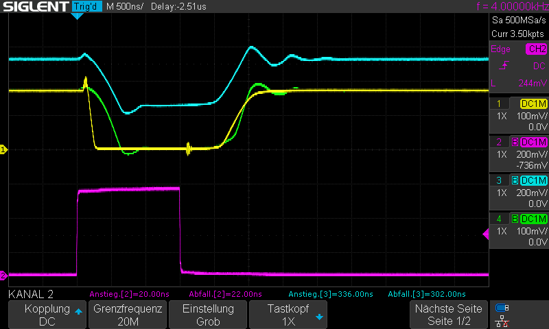

So, what to see:
  • oscillation is mostly gone! :slightly_smiling_face:
For remaining oscillation I noticed that, with reference to blue curve during switching current on again that there is a linear rise of OpAmp's output voltage. Rise is about - no kidding - 7V/s, which is OpAmp's maximum rise time as per data sheet. I.e. I think oscillation is actually not caused by low phase margin rather non-linear behaviour of OpAmp.
I slowed down the reference signal and got this:
Ok, still to fast but on the limit of the OpAmp. Measured current (green) catches up with the yellow during turn on, then some "recovery" in the closed loop as Gate voltage for MOSFET was to high (but delayed due to limited rise time!), so output current had to catch up again ...
So, I think, I either accept the oscillation (as know it is better understood), or try to find an OpAmp with higher dv/dt, and probably slow down the switching in general.
Note: Pulse width at 2kHz PWM has been adjusted to look nice on one screen both rising and falling, but was a little longer than final pulse width to be used.

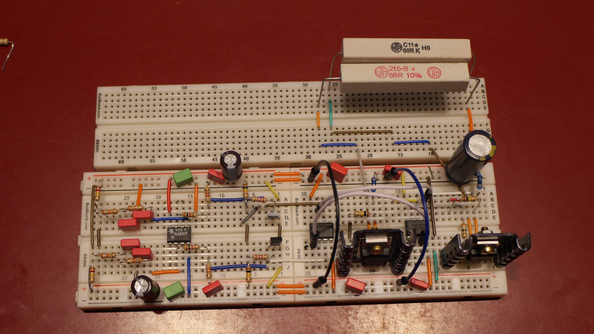

I have no means to meaure it. 0.5W metall film resistor. You can find the resistor on the top right of the breadboard. The resistor right next to the big capacitor.

:smiley: Ah, not those monster-resistors :sweat_smile: I just had in my big box of unsorted elements. In their current-capabilities totally oversized - I drive the test at about 100mA, which is close to final.
Sorry, wrong description. The shunt is right to the big capacitor in the middle right of the picture. The two big ones I use to simulate the load. And, as said, are totally oversized... but work so far ... in case they cause the oscillations I'll track this. As decribed somewhere above, I'm slowly increase complexity of my test set-up to always know what is new and then to properly understand new effects (if there are some). Better then putting all together from the very beginning having various parameters that can drive things not working ...

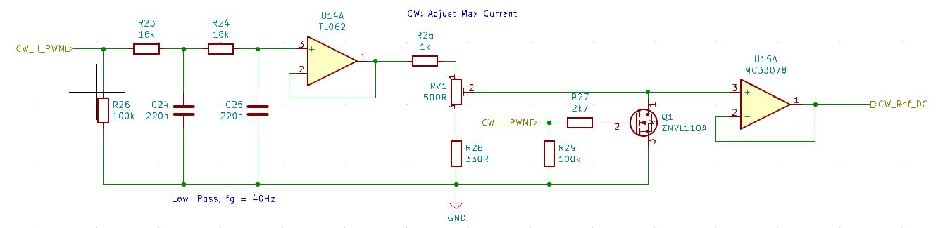

To allow you to follow please have a look on schematic below first:
Circuit is doing three things
  1. DAC from PWM-output by means of simple low-pass. Output of U14A is proportional to load current at 100%.
  2. Lowering reference voltage to be measured across shunt resistor. Shall be 2V at 100% load current.
  3. Q1 is used to apply PWM when desired (running at 2kHz)
  4. Output if buffered by U15A, and will is fed into voltage controlled current source shown in #1

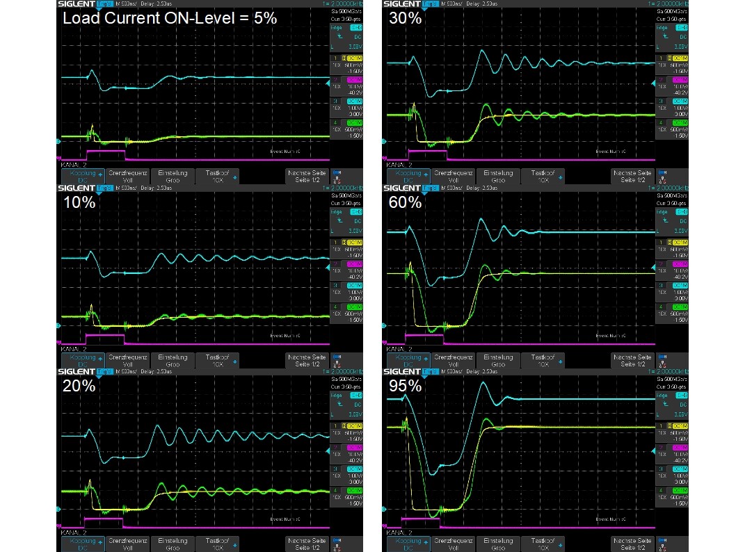

Have a look at one measurement (10x probes, all probes with individual GND-connection as close as possible, Coax-Cable from function generator, thick wiring from labatory supply).
Colors as before. GREEN shall follow YELLOW. BLUE is driving voltage for MOSFET. PURPLE command to switch MOSFET off (CW_L_PWM)
Looks nice, doesn't it?
Well, then I changed the duty cycle of the just shown schematic to set different load currents (i.e. of the signal CW_H_PWM. The higher the duty-cycle, the higher the amplitude of CW_Ref_DC.
Then I got this (all settings on the scope unchanged):
That's kind a strange, isn't it? At both lower (5%) end upper end (95%) of load current oscillations a well damped. Then, with increasing duty cycle damping gets less to increase again for duty cycles above 30%.
I swear, I haven't touched and wiring during the measurements.
Please note I was able to get scorpe's grid on the screen. So with 500ns/div oscillation is about 2MHz.
Any idea why dynamic behaviour may depend on current levels?

I think the ap amp is driving heavy capacitive load. R39 makes this worse because it forces the op amp output to overshoot to quickly reach the target. As mentioned previously the op amp output saturates, which badly degrades its performance and so it overshoots a lot before it gets back into regulation. Trying to correct the overshoot it saturates in the other direction.
I don't know why this oscillate less at current extremes. It is interesting observation but I don't think a single cause can be found - it may be combination of many subtle factors. As long as the oscillation is damped I don't think it does matter. You may try to show down the change of the reference and increase speed of the op amp by removing R39.
Try adding a driver between the op amp and the MOSFET. Use a common collector NPN with a low value emitter resistor load to ground.

Q3 is configured as source-follower, that is the gate capacitance is bootstrapped (both plates of Cgs move (almost) by the same amount of input voltage because gain of source follower is (almost) one. So input capacitance becomes just
Cin = Cgd + Cgs / (1 + gm*Rs) with Rs = R42. Having gm for sure above 1S (or some low 2 digit number) Cin is approximately Cgs
Honestly, I had toughts in the same direction. But then I figured out that Q3 is running as source follower and concluded that capacitiy load to OpAmp shouldn't be a problem because it is loaded with just (small) Cgd.
Does your proposal still holds taking the source follower into account? Despite, I would need a sketch because I don't understand exactly would you mean ... sorry.
One thing - it's not exclusively a source follower if the voltage on the drain is of opposite AC polarity to the voltage on the gate. That will induce some negative feedback through the parasitic drain to gate capacitance.
With any such circuit that relies on closed loop control, the op amp feedback loop includes all the reactance of the driven circuit that is included in it. So compensating it can be tricky if the reactance is high. The higher the loop gain, the more stability becomes a problem and a voltage follower is a worst case for that.

Regarding your scope shots, it's not clear to me exactly where in the circuit you have connected the probes (especially the blue and green, which I assume are somewhere in the output stage).
This I can quickly answer:
BLUE: Output pin 1 of U16A. So it can be seen that output of OpAmp does't saturate but slew rate can be observed.
GREEN: at source of Q3, i.e. voltage across shunt resistor R42. That's why I write GREEN follows YELLOW, which is CW_Ref / Pin 3 of U16A
