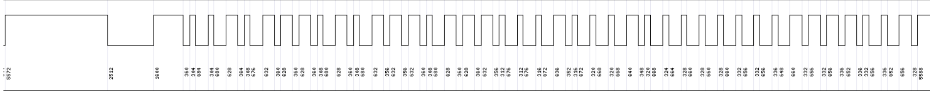

Edit:
Wave from remote:
QrokPL:

how did you read this? oscilloscope? serial monitor? ...?
Arduino + 433MHz modul. (serial monitor)
I don't think pulseIn() is going to work for you. It can't read consecutive HIGH and LOW pulses. When the HIGH pulse ends and you call pulseIn(pin, LOW) to get the LOW time it will wait for the next falling edge to start timing a LOW pulse. Since the HIGH pulse ended on a falling edge you already missed that edge. It has to wait until the current LOW ends and the next HIGH starts before it can look for a falling edge. That means if you have pulseIn(pin, HIGH) followed by pulseIn(pin, LOW) you will miss a LOW pulse and a HIGH pulse between the two measurements.
There are libraries for receiving and decoding IR signals. IRremote and IRlib2 are popular. They should work on RF signals as well.
I will try it, I'm desperate. I try to decode this for months (I'm very low skilled).
"It can't read consecutive HIGH and LOW pulses."
If you compere readout from wave and my bits its line up perfect:
0010111010111011100000111000000001110111
For this low skill purpose it is ok i think.
