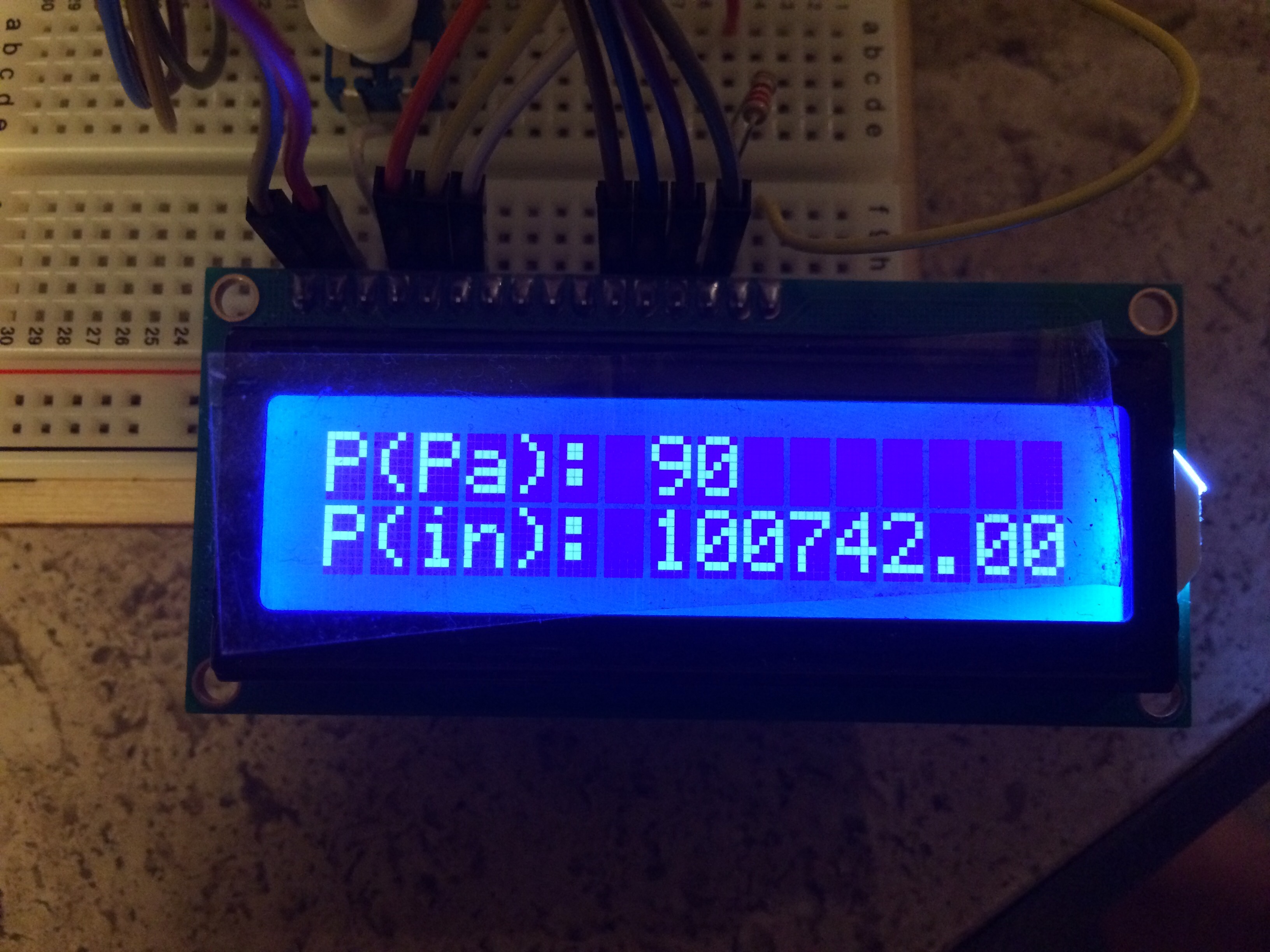

I'm receiving the data in the receiver but I can't display the values to the LCD screen. I would like to be able to display the following: "TempC: 18" in the LCD and then have it update as new data comes from the Tx.
Questions:
  • I believe "TestData" is declared as an array but I haven't been able to extract values using the "strtok" function. Is this the wrong function to use? If so, what is a better function?
  • Once the values are extracted from the array, how would you pause Serial and print the values to the lcd? Any suggestions?

Thanks for replying. Correct, the previous code posted only prints to the Serial Monitor. I was curious how others might attempt at solving my problem of having the data print to the SerialMoitor as well as the LCD.
For General Reference I used this forum posting: sending all sensor read in one time via xbee (my home monitor project) - Networking, Protocols, and Devices - Arduino Forum
For Parsing Reference I used this forum posting: Parsing serial data sent to an arduino - Troubleshooting - Arduino Forum
I attempt to use the "strtok()" and print TempC and TempF values to only the LCD with the following code.
Receiver Code:

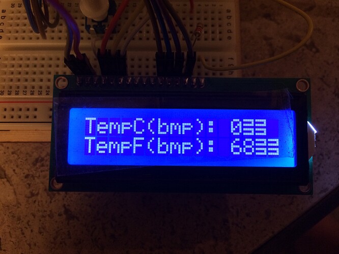

      lcd.print("TempC (bmp): "); lcd.println(TestData[0]); //print out the data stored in the value storage array index '0'
      //set cursor to next line using appropiate commands again
      lcd.print("TempF (bmp): "); lcd.println(TestData[1]); //ditto

The code uploads fine, but the LCD doesn't display the data the way that I thought it would. It includes weird characters and doesn't always start a new line with TempC or TempF. See attached image.
Also, I was hoping to be able to see the data in the Serial Monitor as well as the LCD. When I add the following "Serial.print (Xbee.read());" code in the loop section

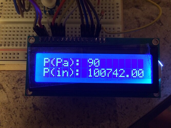

Thank you so much for your comments. The Serial Input Basics is a great resource and the clarifications regarding array format were both very helpful. I have been wondering that for a long time and it is now clear! Thanks! The weather station is closer, but still not ideal.
The LCD is displaying labels and values but there are still issues.
  1. There are weird characters being displayed. Ex: TempC, TempF, HIC, H (see Image 2a attached).
  2. Values are not being displayed at all. Ex: TempC (see Image 2a attached).
  3. Variables seem to be displaying incorrect values. Ex: P(Pa) displayed the value 90 one cycle and then -30336 the next cycle through. P(in) displays 100742 which should be displayed for P(Pa). (see images 2d & 2e attached).
When checking Tx code Serial monitor it displays the following data as expected
<20,68,20,68,20,68,89.80,17,100768.00,755.76,29.76>
but this isn't how it is being read on the LCD display. Thoughts?

Photos are attached here.
lcd.println
You have several statements like this. The lcd library does not use the new line instruction. It will produce garbage on the screen. Use cursor placement for new line location control.
I think you also have a typo here:
//TempCbmp, atoi(strtokIndx); // copy it to TempCbmp
TempCbmp = atoi(strtokIndx);
Thank you. All the wierd characters now seem to be gone but I'm correct values are still not displaying on the LCD screen consistently. It shifts from values like THIS:

P(in): 29.971
TO VALUES LIKE THIS:
Temp(dht)C: 1
H: 17.00
P(Pa): 95
P(mm): 16.00
P(in): 101489
I don't understand why the values are changing so greatly over 24 seconds.
Any thoughts or suggestions?

Thank you cattledog. I'm sorry for the delayed response. You're suggestions work great and seem to have solved the issue regarding data being displayed inconsistently. I don't fully understand what the changes do so I'll need to do some reading on the changes. Thank you for your suggestions suggestions.
There is still an error when displaying the Pressure in Pascals ("P(Pa)") to the LCD screen. The Tx data being sent is displayed as "101900.00" in the outgoing data:
<19,66,19,67,19,67,84.60,15,101919.00,764.39,30.10>
<19,66,19,67,19,67,84.70,15,101904.00,764.28,30.09>

...but the Rx displays the value on the LCD screen as -29142. Not too sure why this is happening. Any thoughts?
Thanks again for the support.
Don't have time to dig in to the specifics (cooking dinner) but your issue smells like use of an int to store a number that won't fit. 101904 is such a number, so I suspect that somewhere in your RX code, the pressure value is passing through a sixteen bit signed integer.
Wildbill is correct. Very good sense of smell :slight_smile:

Declare P1bmp as a long and Use atol() instead of atoi.
P1bmp = atol(strtokIndx);
Sorry for the late reply and thanks for your reply cattledog. This didn't seem to help the values printed out on the lcd screen though. The LCD screen still displays a negative number of "-29963". I don't understand why?
The posted code still has
int P1bmp = 000000;
Oh, you're so right and this did it! It all works. This feels like a huge milestone. :slight_smile: Thanks again everyone for their help and advice! Final code is paste below for those who are interested.

        lcd.clear();
        lcd.setCursor(0, 0);
        lcd.print("P(Pa): ");
        lcd.print(P1bmp);
        lcd.setCursor(0, 1);
        lcd.print("P(mm): ");
        lcd.print(P2bmp);
      case 6:
        lcd.print("P(in): ");
        lcd.print(P3bmp);
        newData = false;

  void showParsedData() {
  lcd.clear();
  lcd.print("TempC(bmp): ");
  lcd.print(TempCbmp);
  lcd.print("TempF(bmp): ");
  lcd.print(TempFbmp);  // Round 1 of data display complete
  delay(4000);
