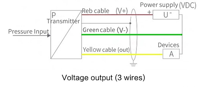

I have an Arduino-related problem with a 3-wire water pressure transducer that outputs 0–5 V through its yellow wire; the sensor takes 24 V DC from an external power supply that I have bought ad hoc (GACUN-2410, output 24 V 1.0 A). The sensor is QDY30A (https://www.aliexpress.com/item/1005004607235726.html), and its technical specs and schematics are below:
Now, I tried that the sensor works with a multimeter (the made-up figures in the figure below are in volts). I always thought that the sensor output loop's end has to be connected to ground, but to my surprise it actually needs to be connected to the 24 V power supply's negative wire or it just gives 0.00 V as the reading, regardless of the pressure.
I also tried to connect it to my Arduino Uno's A1 port, but all I got was the reading going from 1023 to 0 and then -> 1023 -> 0 -> 1023 -> 0 in a very rapid, endless cycle on my LCD shield's display.

Now I'm puzzled about what to do: how to wire the sensor correctly to Arduino and make a working loop here so that I get a reading through an analog input port? As stated, the system works perfectly with a multimeter connected to the output wire and to the negative wire of the DC power supply, now I only need to transform this to work with Arduino.

The sensor gnd and the controller gnd have to be connected together, this is so they all have the same gnd or 0V reference.
Your controller is the "Devices".
My read on your sensor is it is powered by 24 VDC which is very common for sensors like you have. I also assume your sensor has a range of 0 to 2.0 meters corresponding to a 0 to 5.0 voltage out proportional to water depth. You have a low pressure sensor.
Next I assume an Arduino Uno or similar having a A/D (Analog to Digital) input of 0 to 5.0 volts. Since the sensor out is referenced to sensor ground your Arduino and your sensor need to share a common ground. You found that out.

Thanks @TomGeorge! So if I understand correctly, this setup should provide sensible readings:
@Ron_Blain thanks, indeed I need to do the calibration and conversion calculations and convert the AD signal bits to real-life data. Luckily it's all very easy once I get the electronics right. I was thinking about conducting a linearity test as well to see how the signal behaves as a function of depth. Hopefully it's linear, but it's no problem if it follows a quadratic equation. The sensor measures from 0 to 5 metres, i.e. 0 V is no water and 5 V is ≥5 m.
Your last drawing is fine. Your Arduino and your sensor need to share a common ground as you drew it.

Thanks, the system is now working perfectly, with the LCD showing the depth (in metres with two decimals if more than 1 metre and in cm if less than 1 metre), fill % and water amount in litres correctly.
Currently 3.9 metres; the overall depth is 5.0 m so there's 1.1 m of water.
Lesson of the day: finding a common ground makes things work not only in social situations, but also in electronics.
