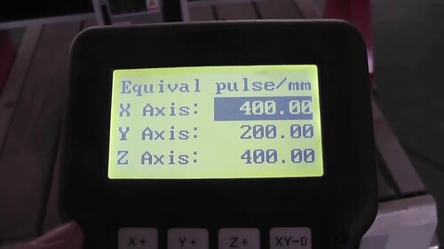

I working on project that have a file chooser screen, and I want highlight a currently selected file. Like on second image. But I have no idea how to achieve this?
It is possible to read currently printed character as a raw pixels into some array, then just apply invert mask and write data back to LCD? I try achieve this a few days, but my skills is not so good.
Is there some code examples to achieve this?

Finally, I did this.
Solution:
  • initialize LCD in basic (character) mode;
  • print some text;
  • switch LCD to extended (graphic) mode;
  • don't clear text, just draw filled rectangle;
  • switch back to basic mode;
  • done!
