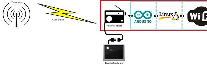

We created a small shield that contains a receiver.
(This PCB can work standalone as well, but is plugged into the Arduino connectors, hence shield)
Checking the over the air data transmission
I have a laptop with a terminal program via cable connected to the receiver.
This terminal program shows the data string correct whenever the transmitter sends it's string.
Hence..... The transmitter works and the receiver works.
This cable connection and terminal software is just for debugging purposes and will not be part of the final design.
The pin the terminal is listening on, is also connected to the Arduino pin D2. (And ground is connected as well off cause)

The Rx pin used by the SoftwareSerial would be in input mode, meaning it's a high impedance. Usually that would prevent it from affecting the circuit it is connected to. The Tx pin would be configured as an output and driven low when it was idle. Does your shield make any connection to pin 3?
Looks like you have an rs232 output from the receiver, which probably works with the pc serial port, but would not work with a TTL rx on the arduino without be converted.
