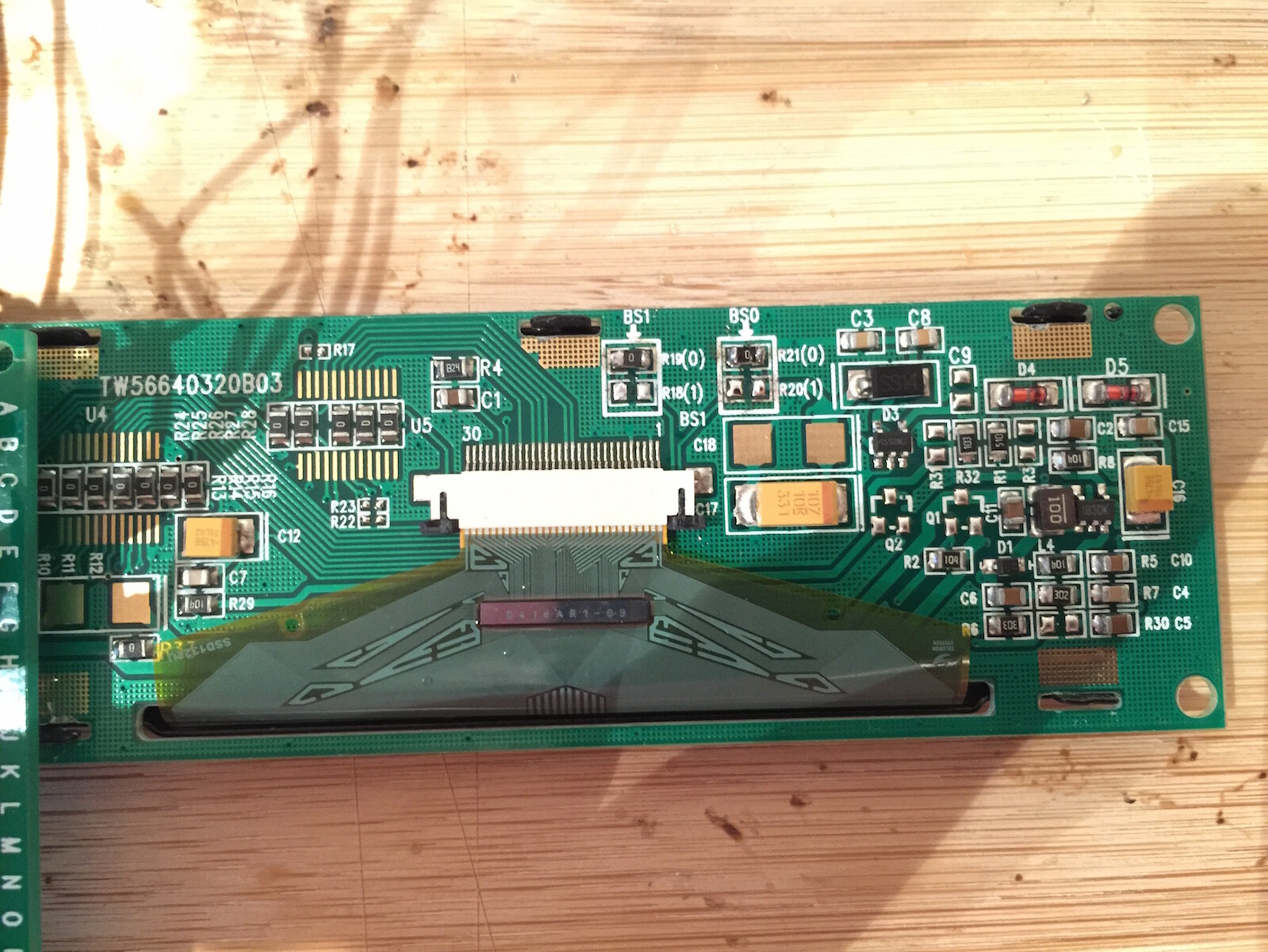

Hi Oliver!
I need your help!
I have this screen: http://www.buydisplay.com/default/oled-3-2-inch-displays-module-companies-with-driver-circuit-blue-on-black
I used this constructor: U8GLIB_NHD31OLED_2X_GR u8g(13, 11, 10, 9);
I soldered BS1-0 and BS0-0
R19 and R21 = ON
R18 and R20 = NC
It uses 4 Line SPI scheme and I successfully connected it to my Adruino UNO, but I have noisy screen.
What problem could be? I was trying to use Uri's solution step by step - but nothing!

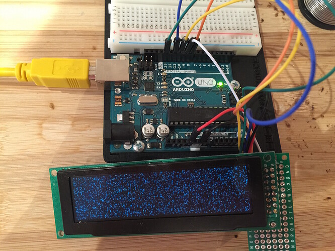

Hi
What means "successfully connected"? What is a noisy screen?
How are lines connected? Do they match the u8glib constructor?
Maybe you can post a picture of the display and Arduino together.
Oliver
Connection regarding photo:
Green Wire: SCLK (4pin on screen)
Blue Wire: MISO (5pin on screen)
Yellow: CS (16pin on screen)
White: A0 (14pin on screen)
Orange: reset(15pin on screen) (but it doesn't mater if it's disconnected)
Constructor:
U8GLIB_NHD31OLED_2X_GR u8g(13, 11, 10, 9); // SPI Com: SCK = 13, MOSI = 11, CS = 10, A0 = 9
Where:
13 - SCLK
11 - MISO
10 - CS
9 - A0
and for code, I use examples from U8glib library
Hi
You should inform U8glib about the reset line (5th argument):
U8GLIB_NHD31OLED_2X_GR u8g(13, 11, 10, 9, 8);  // looks like reset is at pin 8 of the Arduino according to the photo
According to the SSD1322 datasheet, D3..D7 (pin 8, 9, 10, 11 of the OLED) must be connected to GND.
Did you also try the BW variant as constructor?
Oliver
Edit: Code tags
Thanks Oliver!
It works now! The mistake was in soldering, I connected 13 pin instead of 14pin on the screen for A0! And I added 5th argument to the constructor!
Thank you for your advice!

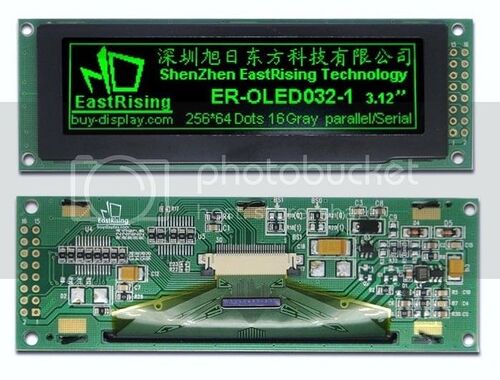

Thanks to this thread, Oliver Kraus' inputs & u8glib graphics library I was able to enable an East Rising 256x64OLED model ER-OLEDM032-1G connected to Arduino Uno through the hardware SPI bus
Video link:
Arduino with Graphics 256x64 OLED
To enable 4 line SPI the data sheet mentions -
1)0 resistor (jumper) connected on :
R19 below marked BS1
R21 below marked BS0
2)shorting to ground (-ve) pins :
7 DB3
8 DB4
9 DB5
10 DB6
11 DB7
12 /RD
13 /WR
While ordering the OLED, I asked the seller to solder the resistances - R19 & R21 for SPI 4 line mode prior to shipping.
