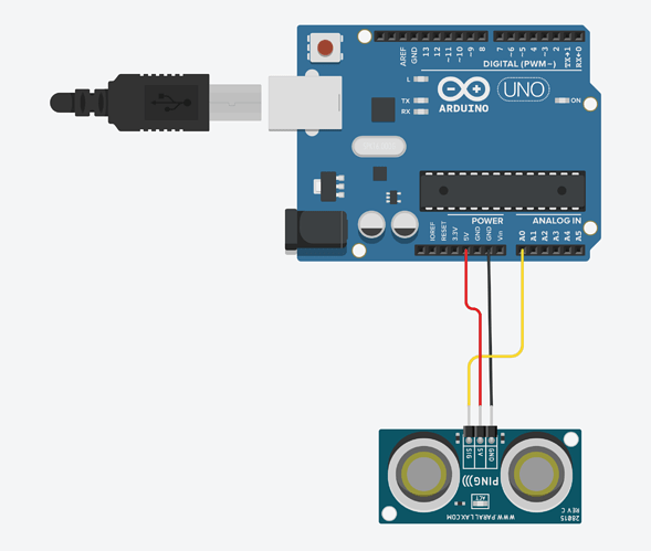

No wiring diagram or schematic?
Please post a schematic as requested by aarg, possibly a picture and links to technical information on the hardware devices.
Random readings are a sign of a wiring problem and floating input.
Please post links to the exact UV sensors you have.

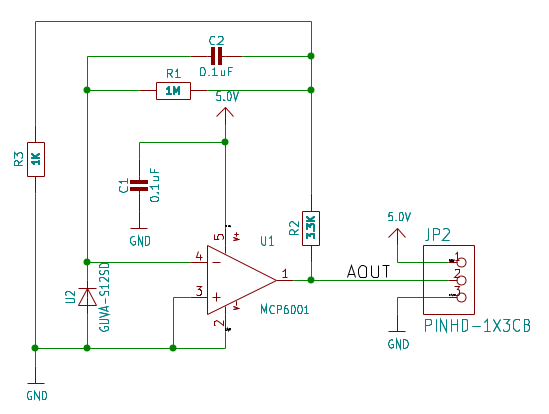

Adafruit schematic:
afbeelding
The circuit is sensitive for noise. I trust the Adafruit module that it works okay. I don't know about the ElectroPeak module.

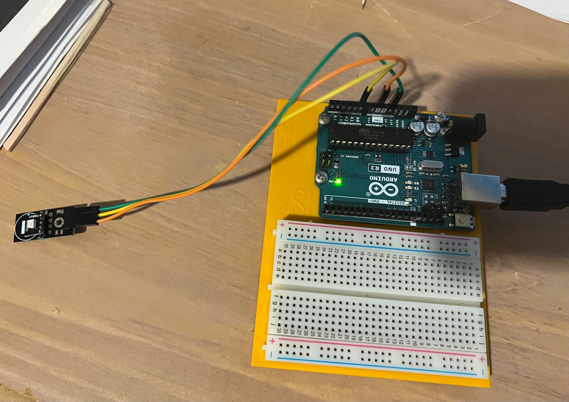

First Schematics, here is what I was able to make in Tinkercad, I couldn't find a UV sensor so this is what looked the most similar
And this is a picture

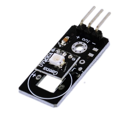

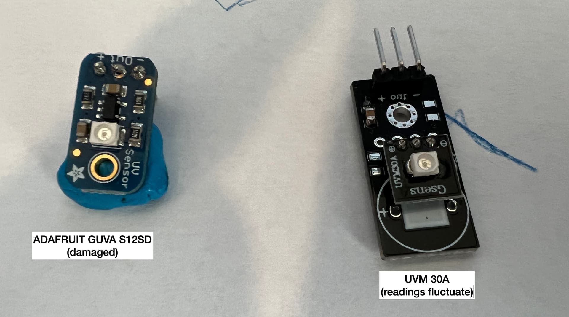

the sensor pictured is a SMAKN UVM-30A purchased from amazon, I could not find a schematic of how this sensor is made. I apologize, but maybe I just don't know yet where to look for it.
This is the info I could find about it:
Product Name : UV Sensor Module;Model : UVM-30A;Operating Voltage : DC3-5V
Output Voltage : DC0-1V;Operating Current : 0.06mA(Typical),0.1mA(Max.);Response Wavelength : 200nm-370nm
Operating Temperature : -20C to -85C ;Testing Accuracy : +/- 1UV Index;Total Size : 35 x 13 x 7mm/1.4" x 0.51" x 0.28"(LWT)
Material : Plastic, PCB, Iron;Color : Black
Weight : 3g;Package : 1 x UV Sensor Module

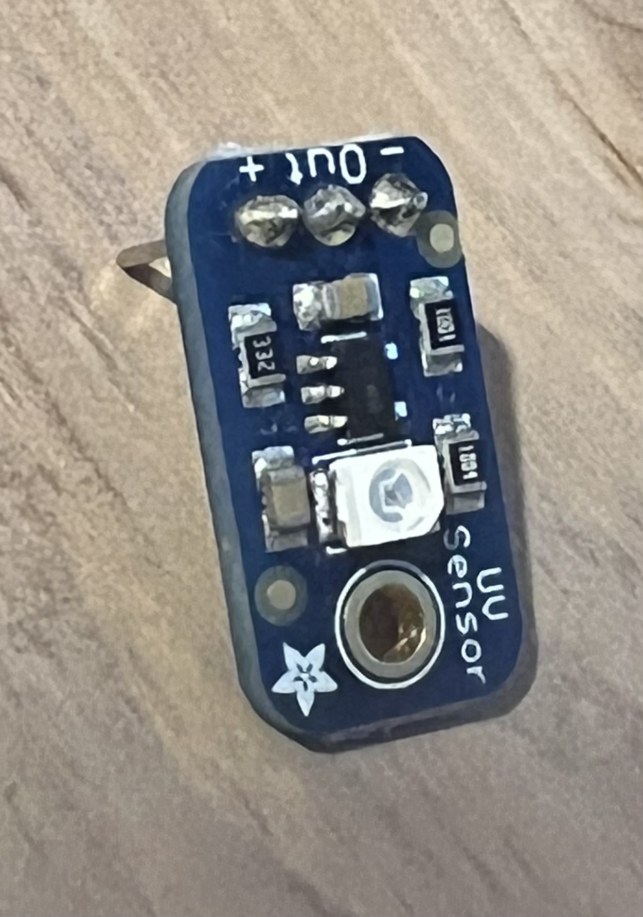

The other Sensor i used was the Adafruit GUVA-S12SD, also purchased from Amazon and pictured above by Koepel.
I used Koepel's code with the SMAKN UVM-30A and definitely got much more consistent readings, I learned the lamp needs time to warm up and changed the delay a few times, It seems like 2 seconds is the most consistent but I want to tinker more with it.

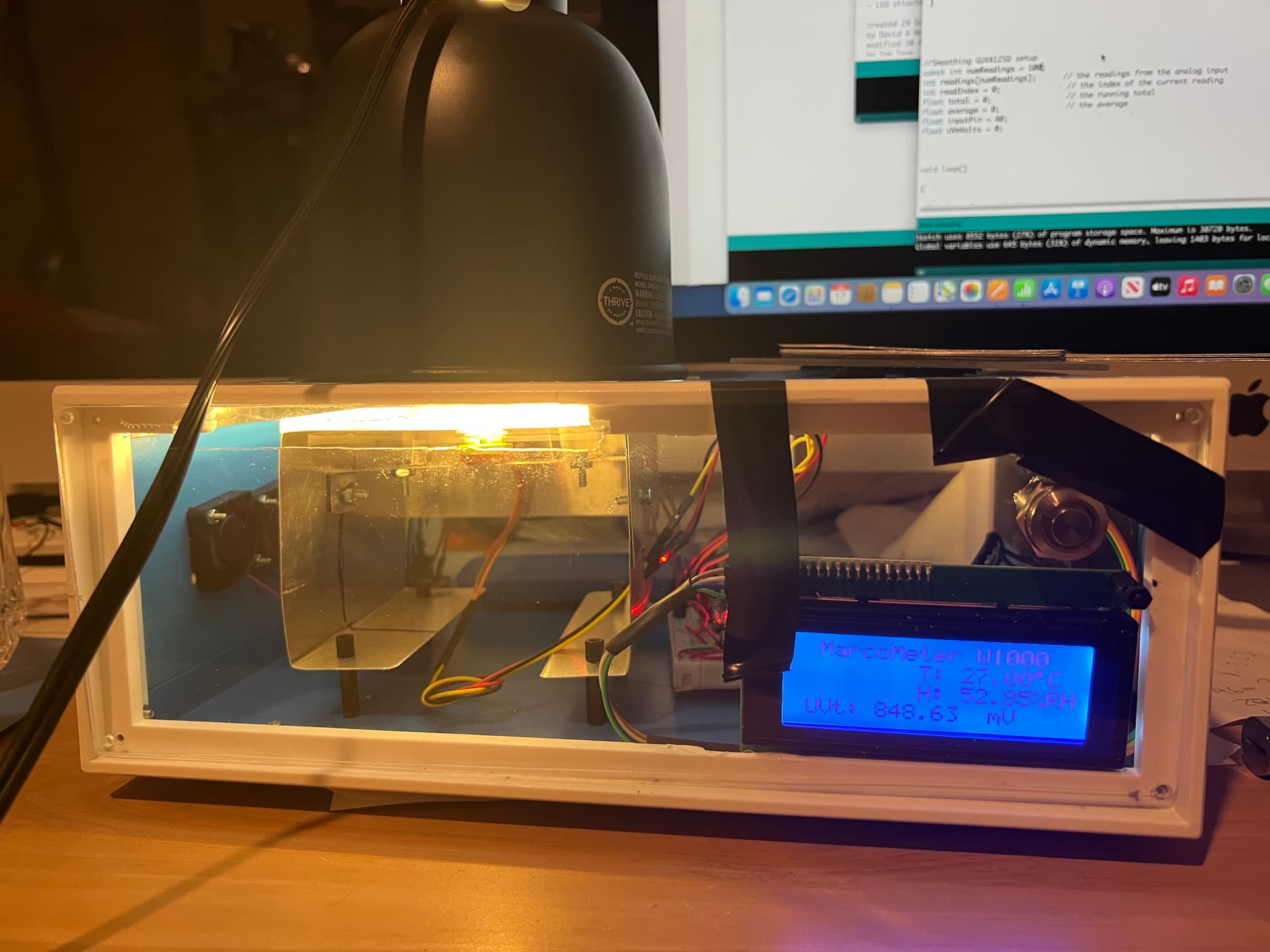

I have ordered a better lamp from a company called ExoTerra, its UV radiation profile mimics sunlight better, It is discontinued but we were able to get one by calling the company directly, hopefully it arrives in the next few days.
I am mostly testing at night indoors, with ambient light the sensors don't read anything, only when exposed to my cell light and now with the UV bulb, but they have to be fairly close.
Because the bulbs generate some heat, I was planning to make our rig inside an old PC case, with the light up top and the fans running. (if we have some time we will try to put temp/humidity sensors inside the box). But from what i can see now, in order to generate larger readings with a lower variability, I think we will need to have the light source right on top of the sample plates which must be just a couple mm above the sensor if we want to see any difference between sunscreen samples.
We are trying to set up our experiment as close as we can to what the FDA requires for their in vitro test without breaking the bank.
https://www.accessdata.fda.gov/scripts/cdrh/cfdocs/cfcfr/cfrsearch.cfm?fr=201.327
So if we can get the UV meter right and a better UV source, we plan to apply sunscreen to sandblasted PMMA plates that we already have, let it dry 10 min, then pre expose the plate to UV rays for 15 min and then do the measurements with a thin layer of teflon film in between as a diffuser to avoid collimated radiation (I am yet to test if the film we got works for this purpose. The FDA calls for 5 different areas of the plate on 3 different plates per product. We cannot do that and we are thinking about getting readings from 3 different spots on a single plate per product. Each measurement being the average of I am not sure how many measurements within 5-30 seconds. The control plate will be covered with glycerin.
The ultimate goal is to obtain transmittance readings (maybe convert them to absorbance if it looks better for his report) that my son can use to compare the different sunscreen samples we have to test.

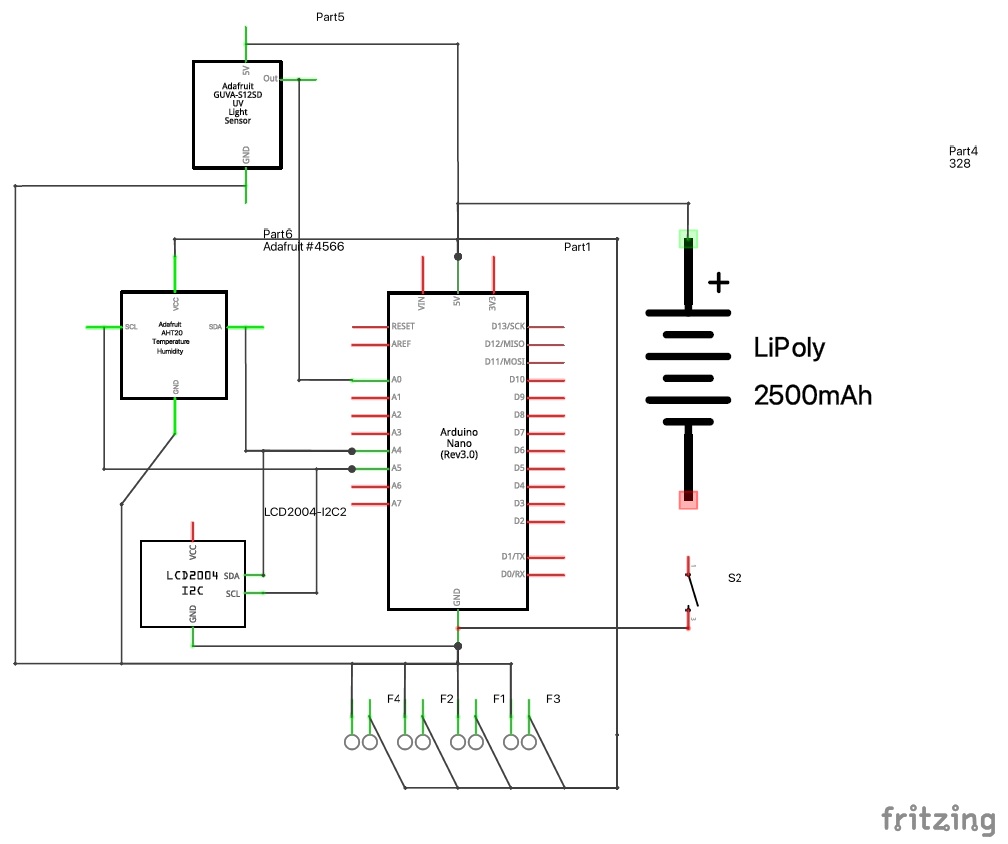

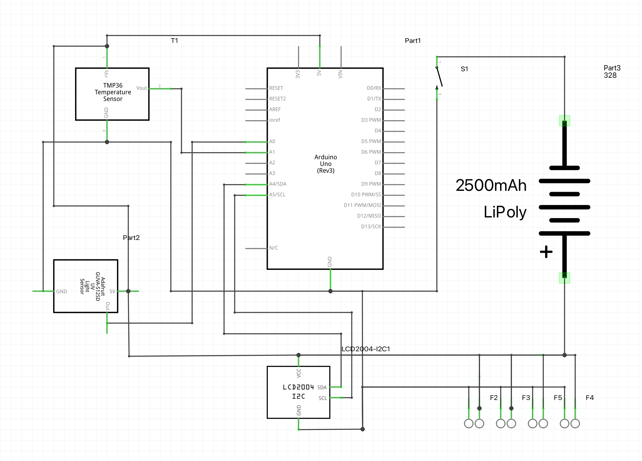

Here is a quick update, I have a few more questions but I will try to ask them one by one.

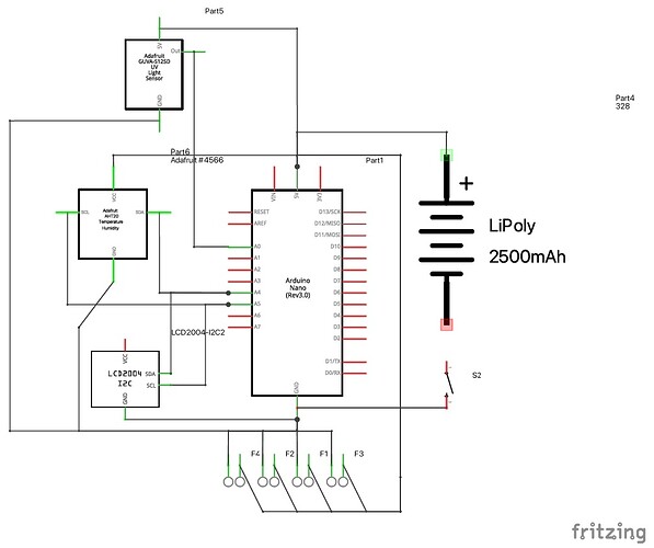

I now have a schematic and a working sketch (I learned to use Fritzing. Code: not yet).

I wanted to ask if someone can help me solve the quandary i am on with the sensors.
I have gotten a few different ones as I am kind of desperate:
Early on I got an Adafruit GUVA-S12LD and a UVM 30A from Amazon.
Links are above in the thread along with a schematic of the Adafruit GUVA sensor.
Unfortunately I think I somehow killed the Adafruit and The UVM kept giving me inconsistent and fluctuating readings.
I since have purchased a couple of Waveshare GUVA S12SD sensors
https://www.waveshare.com/uv-sensor.htm
Also a CMJMCU GUVA S12SD that I do not remember where I got from and can't find record in my CC or email. But it can be seen here:
https://vipotech.com/5pcs-cjmcu-6002-ultraviolet-spectral-intensity-sensor-p-10945.html?currency=USD
Both of these are promising, despite having the same technology, their sensitivity varies a lot. They both take 20 or 30 seconds to stabilized once exposed to the UV lamp but after that they are steady (I have tested them both for 6-8 min continuously)
We are still using a fluorescent lizard bulb, we purchased metal halide bulb with better UV spectrum but it arrived broken and a replacement may not get here in time.
The Waveshare (blue) gives very consistent readings although much lower, in the range of 300 to 600 with the bulb 1 cm away.
The CMJMCU (purple) is much more sensitive, which we liked because it makes our lives easier to see small variations once we start comparing sunscreen samples. The problem is that the reading tops out at 1021 or 1019 even with the lamp 6 inches away. which is a problem to us since our sample sits very close to it in our device. I tried using a simple sketch to test it and that did not correct the problem.

There are at least two different designs for those UV sensor modules, with amplifier gains that are vastly different. The higher gain version is just about useless to measure sunlight and similar intense UV sources.
The Adafruit sensor and close copies work fine, if you use an ADC with ~ 1 V full scale (such as an Arduino Uno, using the 1.1V internal ADC reference).
To calibrate you will need an instrument that is already calibrated so you can compare the readings and create a formulae or a look up table for the correction value.
It's perhaps an op-amp and linear circuit question?
The datasheet for the GUVAS12SD is here:
http://www.geni-uv.com/download/products/GUVA-S12SD.pdf
That gives you the current generated vs W/m2 of UV light.
From that and the op-amp schematic you should be able to work out out voltage vs uv intensity.
By changing a resistor or 2, you could change the op amp's working range to a different range of uv light levels?
The datasheet suggests that diode is good for up to 100mw per sqcm of UV, not sure how that relates to summer sunlight? The graphs on the data sheet show its operating range goes up to at least 3x the UV irradiance of when the UV index is 15, so if you're working above that range I'd be more concerned about fried retinas than your code/circuit not working?

Hello guys, I just wanted to ask if someone can take a look at my code. I changed my temp sensor from a TMP36 to an AHT20, it seems better and also gives me humidity, but somehow implementing it with the intervals code I was using made my UV readings sluggish. I am using the smoothing code example and my results were tighter but they changed fast, sometimes faster than the LCD could handle. After the AHT20, that changed and the UV updates in the LCD were every few seconds.
I thought it had to do with the intervals code somehow, so I set out to fix it the only way I know, that is, find some other thing that looks like it may work. I came across with this page and basically substituted old lines for new ones.
All I want is smooth UV readings that are as steady as possible so i can trust them and just reassurance that temp and humidity are ok( every 5 seconds is more than fine.
I have modified the millis for the UV read from 100 to 10 to 5 ms, also changed the smoothing number of events from 10 to 100 and I don't see much difference, (variability of readings is still around 1.5 to 2%). I have noticed that while I think I am asking both the serial monitor and the LCD to read the same number, the LCD changes every 3-4 seconds, while the serial prints sometimes twice or even three times with the same time stamp

Here is the sketch as it looks now:
   Based on work by the following sources:
Sensors
  by Michael James (May 2019)
  https://www.programmingelectronics.com/arduino-millis-multiple-things/?utm_source=YouTube&utm_medium=Video%20Description&utm_campaign=Lead%20Gen&utm_content=millis%206
Smoothing
  created 22 Apr 2007
  by David A. Mellis  <dam@mellis.org>
  modified 9 Apr 2012
  by Tom Igoe
  https://www.arduino.cc/en/Tutorial/BuiltInExamples/Smoothing
AHT20 library
   Priyanka Makin @ SparkFun Electronics
   Original Creation Date: March 31, 2020
   http://librarymanager/All#Qwiic_Humidity_AHT20
LCD info
  https://wiki.dfrobot.com/I2C_TWI_LCD2004_Module__Arduino_Gadgeteer_Compatible___SKU_DFR0154_#target_5
  Modified by MN & KN. Jan 15, 2022.
//Libraries
  #include <SparkFun_Qwiic_Humidity_AHT20.h>
//Declarations
  AHT20 humiditySensor;
  LiquidCrystal_I2C lcd(0x27,20,4);
//Millis stuff
  const long eventTimeGUVA = 10; //in ms
  const long eventTimeT_H = 5000; //in ms
  unsigned long previousTime_1 = 0;
  unsigned long previousTime_2 = 0;
  lcd.init();
  Wire.begin(); //Join I2C bus
  //Weird stuff that makes LCD to crash and temp read negative if i take it out
  if (humiditySensor.begin() == false)  {
    Serial.println("AHT20 not detected. Please check wiring. Freezing.");
    while (1);
  Serial.println("AHT20 acknowledged.");
//Smoothing GUVA12SD setup
const int numReadings = 100;
int readings[numReadings];      // the readings from the analog input
int readIndex = 0;               // the index of the current reading
float total = 0;                 // the running total
float average = 0;               // the average
float inputPin = A0;
float UVmVolts = 0;
 /* Updates frequently */
  unsigned long currentTime = millis();
  /* This is my event_1 */
  if ( currentTime - previousTime_1 >= eventTimeGUVA) {
    //Smooth GUVA12SD
  total = total - readings[readIndex];           // subtract the last reading
  readings[readIndex] = analogRead(inputPin);     // read from the sensor
  total = total + readings[readIndex];           // add the reading to the total
  readIndex = readIndex + 1;                      // advance to the next position in the array
  if (readIndex >= numReadings) {                 // if we're at the end of the array...
  readIndex = 0;                                  // ...wrap around to the beginning
  average = total / numReadings;                // calculate the average
  UVmVolts = average/1.024*5.0;
    Serial.print("UV: ");
    Serial.println(UVmVolts);
    /* Update the timing for the next event*/
    previousTime_1 = currentTime;
    /* This is my event_2 */
  if ( currentTime - previousTime_2 >= eventTimeT_H) {
    float temperature = humiditySensor.getTemperature();
    float humidity = humiditySensor.getHumidity();
    Serial.print("           Temp: ");
    Serial.println(temperature);
    Serial.print("           H: ");
    Serial.println(humidity);
    previousTime_2 = currentTime;
  //LCD
  lcd.backlight();
  lcd.setCursor(6,3);
  lcd.print(UVmVolts);
  lcd.setCursor(12,1);
  lcd.print(temperature);
  lcd.setCursor(12,2);
  lcd.print(humidity);
  lcd.setCursor(2,0);
  lcd.print("MarcoMeter W1000");
  lcd.setCursor(1,3);
  lcd.print ("UVt:");
  lcd.setCursor(14,3);
  lcd.print ("mV");
  lcd.setCursor(9,1);
  lcd.print ("T:");
  lcd.setCursor(17,1);
  lcd.print ((char)223);  //degree
  lcd.setCursor(18,1);
  lcd.print ("C");
  lcd.setCursor(9,2);
  lcd.print ("H:");
  lcd.setCursor(17,2);
  lcd.print ("%RH");
Finally before someone rips me another, A while ago Koepel had pointed I wrote poorly the UV readings conversion to mV instead of V (I think its worse now than it was then). I reluctantly chose again to use mV, because it gives me numbers that are easier to use and see in a graph or table for my son's report. I was happy to just go with the raw analog read for this since we would be calculating percentages, but my FIL kept asking what does that number mean and we figured teachers would also ask. I was hoping to convert to µW/cm2, but none of the lamps literature would report irradiance at 1 in (We can't use it farther, because the readings become too low) and after half a day looking into it, we figured calculating it from the irradiance quoted in the box at 4,8,12,16, etc inches would be a nightmare. I switched to an Arduino nano for space savings and I am running t all inside an enclosure with a phone power bank as energy source. The UV lamp is separate and it does need to be hooked up to the wall. Below is a picture and the updated schematic I don't understand much of it, but some of you have asked for it before.
Again, thank you very much in advance.
UV NANO_schem.pdf (652.2 KB)
You should be able to export your schematic as a jpg or png, so it will load as an image in the post.
@redkaili circuit.
What are F1 to F3?
Tom.. :grinning: :+1: :coffee: :australia:
OK, next time. Thank you! :upside_down_face:
What are F1 to F4?
Oh, those are 40 mm fans to help with the heat from the lamp. I'm not sure they do much, but at least they are quiet.
