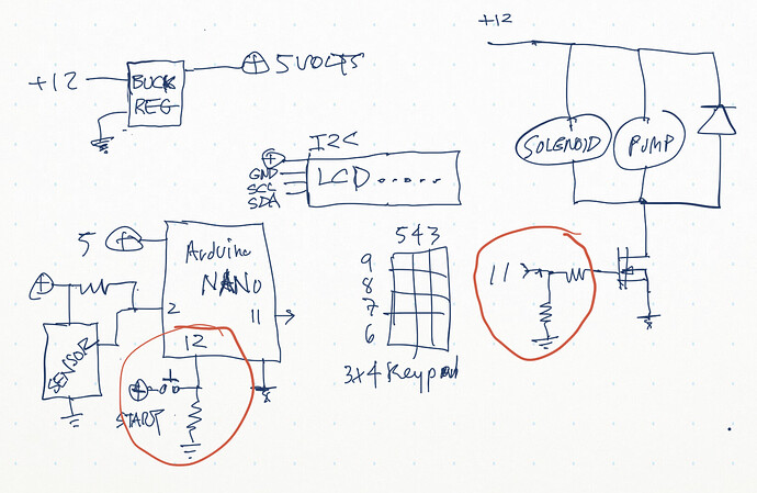

@mountainrock I recast your schematic for my own purposes and to alleviate some dizziness studying it was causing.
I moved the gate resistor with respect to the pull down resistor on the MOSFET. Probably not your problem, bet best practice.
I guessed at what might be attached at pin 12. Is my guess correct?
What values are the resistors that are unmarked?
If it looks like I drew it with my finger I can tell you why. :expressionless:

@alto777 I think the resistances would be standard 1K and 10K, nothing special about this circuit, and the problem isn't with the hardware as we just found out. And yeah, at pin 12 is the button that starts the dance we were stumbling at.
