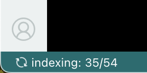

Sometimes the 'hints' (1st pic) does not show
Sometimes the 'hints' (not sure what they are called) does not show see pic 1 and sometimes they do. Is that somehow connected to pic 2? If not, what is pic 2, and why don't hints always work?

The term used for this feature is "Suggest". It is also sometimes referred to as "Suggestion".
Yes. The "IntelliSense" features like Suggest rely on a complete understanding of the sketch program, core, and toolchain. This requires processing all the code files, after every change to the sketch. The "indexing" you see on the Arduino IDE status bar is an indicator of the progress of that processing.
Perhaps because the processing hasn't finished?
Perhaps because you have selected a board that doesn't have "IntelliSense" support?
Do you have the "Editor Quick Suggestions" preference enabled? When you have that enabled, the Suggest interface only appears if there are suggestions available. So it is not expected to appear in other cases. But if you are instead manually triggering Suggest (either via the keyboard shortcut or the "Trigger Suggest" command) then you should at least see and empty Suggest interface appear with the text "No suggestions."

Yes, I know that, I was asking why sometimes they don't appear.
Did not know some boards did not have IntelliSense support. Yes I have Editor Quick Suggestions enabled. Did not know about the keyboard shortcut either, thanks.
