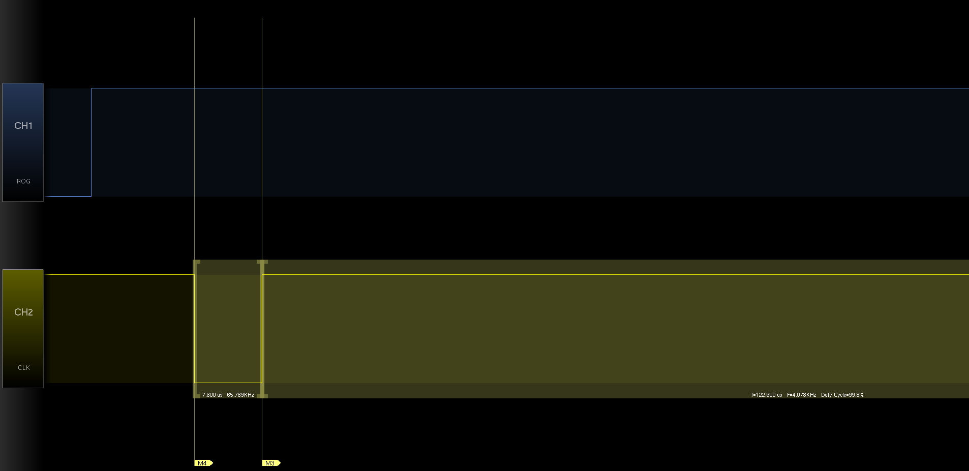

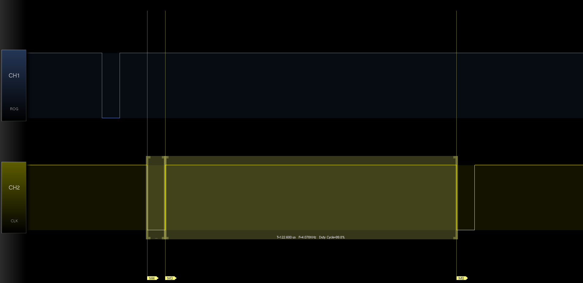

Serial.println("\nstart readout\n");
digitalWrite(clk,HIGH);
digitalWrite(rog,HIGH);
delayMicroseconds(1);
digitalWrite(rog,LOW);
delayMicroseconds(1.01);
delayMicroseconds(5);
for(int i = 0; i < 2087; i++ )
digitalWrite(clk,LOW);
sampleArray[s] = {analogRead(vout)};

I found the only way to get proper data out of the chip was to use a timer to generate the CLK. I also had to speed up the analogue read as by default it is to slow and lastly I read the entire CCD pixels before sending results to PC over serial.
