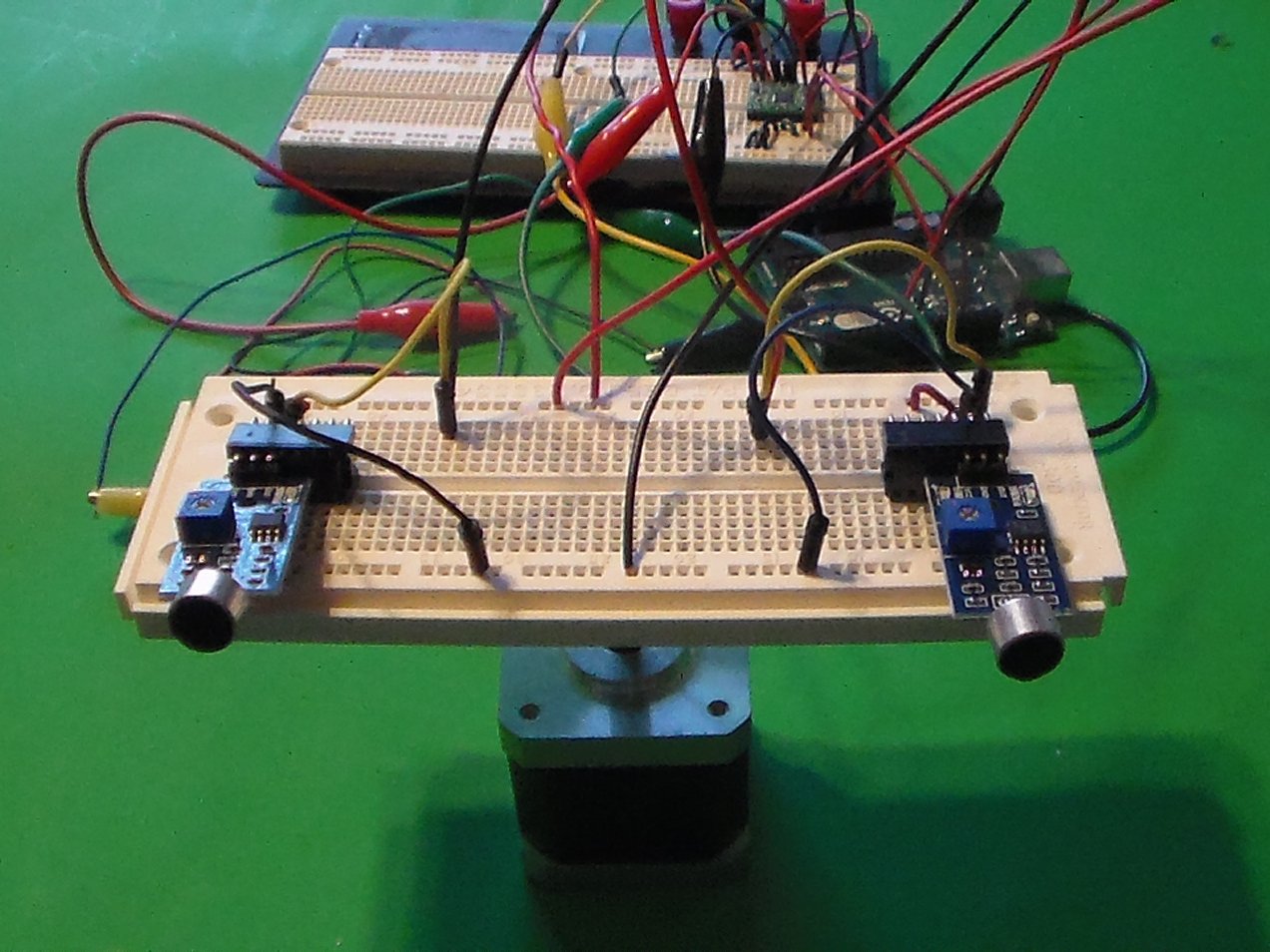

In this thread I have two videos showing my sound source direction algorithm.
The link goes straight to the latter video in the thread. I managed to delete the sound track from the video, but you see me moving around as the serial plotter shows 17 distinctive directions.
In short, I record sound with two microphones. Then I pattern fit the left and right channel sounds and count the time shift. From that I calculate the direction of the sound source.

Right now it's a work in progress Hackster project. I will publish it later tonight.
[edit]
Here:
The basic approach is very nice, thanks!
It is worthwhile pointing out to beginners that the MCU you are using is quite powerful, with a 150 MHz clock, and lots of memory. The approach won't work with lesser Arduinos, like the Uno R3, but should work on an ESP32 or comparable.
