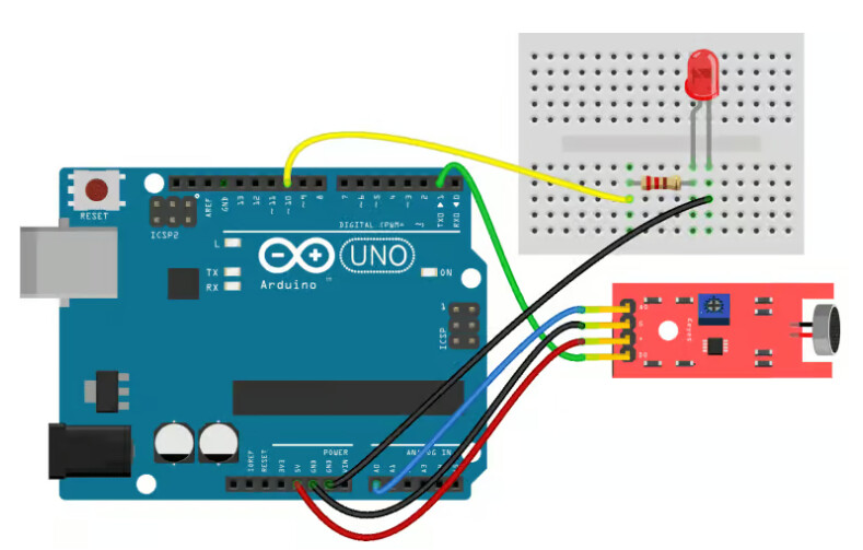

Hi guys, I'm working on a project using this sound module connected to an Arduino Uno:
Link
However it is not working properly, even when I wired it correctly according to this website:
Website
I checked it a lot to ensure I wired it correctly so I don't think that's the issue.

As you can see, the repetitive 14's are an issue. Ive eliminated a significant part of the issue to be the sound module and not the code because when I ran this simple sketch:
const int microphonePin = A0;
    int val = analogRead(microphonePin);
    Serial.println(val);

Wiring used:
I didn't use the LED, and I connected to digital pin 7 and not 1, but otherwise the same thing.

When anything is connected to pins 0 or 1 on an Arduino Uno R3 you will have a problem loading code. Do not do it.
Basically that "sound module" is just a microphone with a bit of gain. You have two options with it.
  1. The output will change from high to low when the input to the microphone exceeds the voltage set by the ten turn screw pot.
  2. The output will be an analogue output of the sound signal.
This module is totally useless for what you want to because when it is wired as configuration 2) it is not sensitive enough to do what you want.
Also to recognise a voice is a lot more difficult than you think it is. It takes using an AI algorithm to perform analysis on the speech waveform.
You will not find a module to do this.

In my wiring, I didn't connect to digital pin 0 or 1, I connected to 7. I viewed both the links you shared; the second only focused on gesture and speech recognition through commands. The gesture recognition is interesting but not relevant at the moment. However, the first one, specifically the use of the NXP Kinetis KL82 to recognize and differentiate environmental sounds, caught my attention. Do you think it could differentiate human voices if trained correctly in the same way it can differentiate environmental sounds? On another note, I found this AI framework that differentiate speakers but it is quite complex and needs to be integrated with a Linux system or something of the sort: Install NeMo Framework — NVIDIA NeMo Framework User Guide
However, I would prefer to use the NXP Kinetis KL82 microcontroller rather than the AI framework, since it is a microcontroller, which I have much more experience with than installing complex frameworks on Linux systems.
I made it, I hoped it could differentiate human voices through converting the analog signal to digital and then comparing the stored voltage propagations with the one that's being used to sign in. But it didn't work in practice. I haven't gone as far as to test the theory of it yet since the readings im getting even with proper wiring and code are wacky but I found that even if it was working, the sound module is incapable of differentiating complex sound waves like human voices so its useless to continue down this rabbit hole.
When I read the linked data sheet, I see the analog voltage is the VOLUME LEVEL of the sound. The digital output is based on the same volume level, but switched 0 to 1 and back based on the POT setting.
The unit DOES NOT do anything with the sound frequency which is what your project needs.
