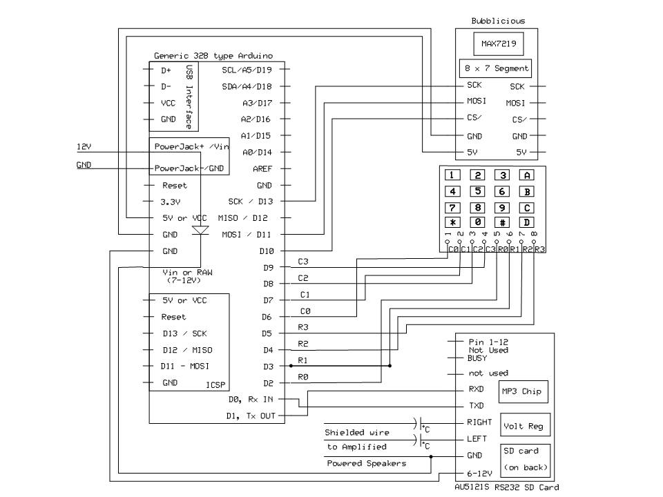

I even tried one myself. The uSD card is on the back of the MP3 module on the left. The display is a "Bubble-Licious" card I offer:
http://www.crossroadsfencing.com/BobuinoRev17/
If you search for "mp3 song player" you might come across the topic I had on this, October-November time frame.
