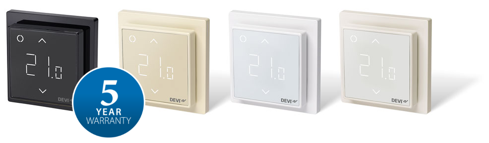

Also just to add for interest sake
The project concept came from an underfloor heating controller we use from Devi, it has the comfort and economy period plus energy readouts on a small touch screen. I could almost use one of these off the shelf and connect it to the spa, but where is the fun in that :slight_smile:
