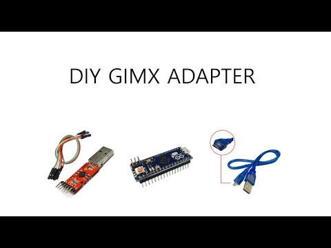

The .hex is downloaded from a creator webside that releses this emulators.
This is the process I'm following to upload this .hex (as you see, this guy has the boa:
The firmwares to emulate ich device is are in this Github page:
Wiki about the whol picture for better underdtanding if you wish:
https://gimx.fr/wiki/index.php?title=Main_Page
Thanks a lot.

The complete setup is the Arduino conected wiht micro USB to the PC and the RX and TX terminals to an 2102 USB converter that also is conected to the PC to another USB port.
At the end, maybe the 2102 device is the only shown in the device manager.
