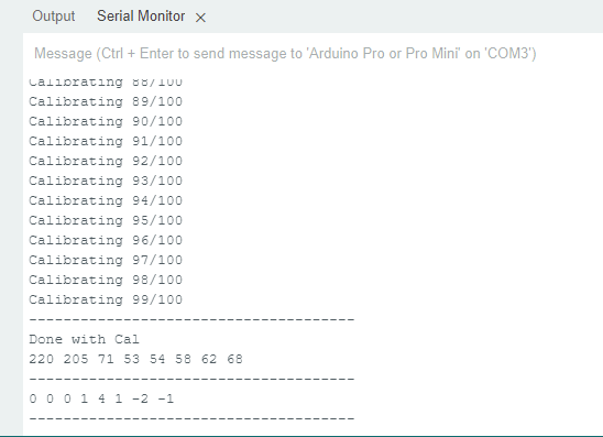

I attempted the correction you pointed out but it didn't make a difference.
I did notice that if I commented out these two lines, the serial monitor posts kinda as it should.
void frequencyGraph(uint8_t x[], int size) {
//int data = analogRead(A2);
//int potSet = map(data, 0, 1023, 0, 255);
int top_threshold = potSet;
and if I comment out just one line, the serial monitor posts the out puts on a single line with no line breaks.
Also, noticed that my initial declaration of potSet can't be zero... it needs to be a value greater than zero to post on the serial monitor.
//int potSet = 0;
int potSet = 35;
I am willing to help you learn to fix your program, but I will not make changes for you. You have discovered how much harder it is to modify someones program than it is to write one from scratch.
But you do not want to learn, so good luck.
what the difference you have on serial monitor when you change 5 to 50 or 100 ?
Good point. I was wondering if it wouldn’t make more sense to map the analog in to a range of, for example, 1-10?
In the original code, I can set the threshold to any value between 1 and 255 and I get this output :
and if I change it to 100, I get...
In the original code, If I set the threshold to zero (0) and I get this output - everything circled in red should be new lines below and I don't get any posts regarding the threshold value like above:
That seems funny to me that it behaves this way - doesn't it?
So, when I attempt to replace Threshold value with the pot setting, the code gets all jacked.
In this latest attempt. The serial Monitor pauses after the calibration routine and doesn't post and pin A0 outputs nor any A2 outputs (for the threshold/potSet).

that is wrong, you declare pin number as threshold value, must be value of the potentiometer = analogRead( A2);
OK... funny, cause I got that from this tutorial:
https://roboticsbackend.com/arduino-potentiometer-complete-tutorial/
Regardless, I tried changing it as follows, but I still get a stalled out program and serial monitor.
This is the latest code I tried.

OK... I had to uncomment:
#include <FHT.h>
otherwise it was a bunch of errors. You probably commented these out for troubleshooting and forgot about it.
After that I still get a couple of errors...
C:\Users\jalbe\OneDrive\Documents\Arduino\FHT_XMas_2\FHT_XMas_2.ino: In function 'void loop()':
C:\Users\jalbe\OneDrive\Documents\Arduino\FHT_XMas_2\FHT_XMas_2.ino:231:15: error: 'top_threshold' was not declared in this scope
 Serial.print( top_threshold ;)
C:\Users\jalbe\OneDrive\Documents\Arduino\FHT_XMas_2\FHT_XMas_2.ino:231:30: error: expected primary-expression before ')' token
exit status 1
Compilation error: 'top_threshold' was not declared in this scope
So then I moved the Serial.print actions to the end of the script after "top_threshold" is declared.
and then I still had an error:
C:\Users\jalbe\OneDrive\Documents\Arduino\FHT_XMas_2\FHT_XMas_2.ino: In function 'void frequencyGraph(uint8_t*, int)':
C:\Users\jalbe\OneDrive\Documents\Arduino\FHT_XMas_2\FHT_XMas_2.ino:256:29: error: expected ')' before ';' token
C:\Users\jalbe\OneDrive\Documents\Arduino\FHT_XMas_2\FHT_XMas_2.ino:256:30: error: expected primary-expression before ')' token
exit status 1
Compilation error: expected ')' before ';' token
so I attempted to correct it:
From:
to
Serial.print( top_threshold );
It would then compile and upload... but only got this on output:
change to this
Serial.print( " top_threshold  =  0 ");
Serial.println();
Yeah, I fixed this already... this is the result I get.

Because @tom321 changed the serial baud rate to 115200.
115200 is a better speed to run your serial at, means the controller responds faster.
This one wouldn't post anything.
I was a little confused with this line... so I commented it out.
so declare it = int top_threshold ;
and then also moved the Serial.print actions to the end of the script after "top_threshold" is declared because of errors again. Was I suppose to do something with the "so declare it = int top_threshold ;".
here's a screen shot of the empty serial monitor.
Oh, thank you, I missed that. I went back and re-ran the previous sketch, but it also paused/froze after the calibration. See screenshot below of serial monitor.
Oops , I don't recall when I did that

Hmm... I get the following error...
C:\Users\jalbe\AppData\Local\Temp\ccO0cHwG.ltrans0.ltrans.o: In function `loop':
C:\Users\jalbe\OneDrive\Documents\Arduino\FHT_XMas_2/FHT_XMas_2.ino:224: undefined reference to `frequencyGraph(unsigned char*, int)'
collect2.exe: error: ld returned 1 exit status
exit status 1
Compilation error: exit status 1
It seems like the script requires the commented out section of void frequencyGraph(uint8_t x[], int size) to be uncommented in order to compile. But if I uncomment it, then I get the following error...
C:\Users\jalbe\OneDrive\Documents\Arduino\FHT_XMas_2\FHT_XMas_2.ino:260:23: error: 'THRESHOLD' was not declared in this scope
   int top_threshold = THRESHOLD;
exit status 1
Compilation error: 'THRESHOLD' was not declared in this scope
If I change int top_threshold = Thresold; to " int top_threshold = Val;" I get the same error
C:\Users\jalbe\OneDrive\Documents\Arduino\FHT_XMas_2\FHT_XMas_2.ino:260:23: error: 'VAL' was not declared in this scope
exit status 1
Compilation error: 'Val' was not declared in this scope
I'm not sure how to redeclare Val in void frequencyGraph(uint8_t x[], int size) without getting errors in the serial monitor.
The value works, it remains to replace THRESHOLD with Val

    // We are in calibration mode.
    if (cal < CAL_TIME) {
      for (int i = 0; i < NUM_PINS; ++i) {
        cal_bias[i] += fht_oct_out[i];
    #ifdef DEBUG
      Serial.print(F("Calibrating "));
      Serial.print(cal);
      Serial.print(F("/"));
      Serial.println(CAL_TIME);
    #endif
      cal++;
      continue;
    // Calibration mode has just ended, crunch data collected.
    if (cal == CAL_TIME) {
        oct_bias[i] = (uint8_t) (cal_bias[i] / CAL_TIME);
    #ifdef DEBUG
      Serial.println(F("--------------------------------------"));
      Serial.println(F("Done with Cal"));
        Serial.print(oct_bias[i]);
        Serial.print(" ");
      Serial.println(F(""));
        Serial.print(fht_oct_out[i] - oct_bias[i]);
        Serial.print(F(" "));
      Serial.flush();
    #endif
