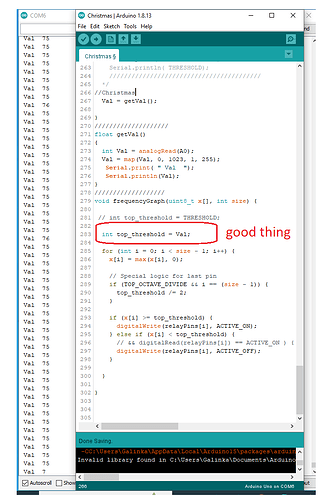

Sorry... I didn't notice, I thought it was still on pin A2. I switched int Val = analogRead(A0); to pin int Val = analogRead(A2); and the serial monitor was posting the variable Val as I turned the pot.

I had to remove */ from line 246 for it to work and got the following.
I also swapped int Val = analogRead(A0); to int Val = analogRead(A2);
It didn't respond to the pot at all.

good thing
Yes... the serial monitor was posting the variable Val as I turned the pot. This works!

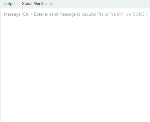

Now, how do we get the rest of the code to post?
if I uncomment Lines 142 thru 248 I only get a blank serial monitor:
first clean up
  1. switch A0 to A2
    2 .move Val = getVal(); to beginning of the loop, line #139.
    3.comment line # 20
    then uncomment lines
    142 - 248
    and
    #68 = //#include <FHT.h>
OK, sure.
    Val = map(Val, 0, 1023, 1, 255);
    Serial.print( " Val  ");
    Serial.println(Val);
    int  THRESHOLD = analogRead(A0);
    THRESHOLD = map( THRESHOLD, 0, 1023, 1, 255);
    Serial.print( "  THRESHOLD  ");
    Serial.println( THRESHOLD);
float getVal()
void frequencyGraph(uint8_t x[], int size) {
 // int top_threshold = THRESHOLD;
  int top_threshold = Val;

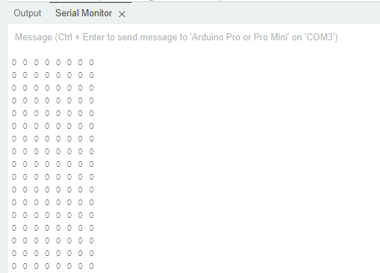

In the serial monitor... the Calibration function runs but then the program doesn't populate any values for Pin A0 and nothing for Pin A2
Run this program again ( post #102 ) and show the results and code
https://forum.arduino.cc/t/spectrum-analyzer-circuit-noise/1132773/101

I tried compiling the code, but I couldn't resolve the errors.
C:\Users\jalbe\OneDrive\Documents\Arduino\FHT_XMas_2\FHT_XMas_2.ino: In function 'void loop()':
C:\Users\jalbe\OneDrive\Documents\Arduino\FHT_XMas_2\FHT_XMas_2.ino:121:3: error: 'Val' was not declared in this scope
   Val = getVal(); //  ++++++++++++++++++++  change #2   +++++++++++++++++++++++++++++++++++++++
C:\Users\jalbe\OneDrive\Documents\Arduino\FHT_XMas_2\FHT_XMas_2.ino:121:3: note: suggested alternative: 'cal'
   cal
C:\Users\jalbe\OneDrive\Documents\Arduino\FHT_XMas_2\FHT_XMas_2.ino: In function 'void frequencyGraph(uint8_t*, int)':
C:\Users\jalbe\OneDrive\Documents\Arduino\FHT_XMas_2\FHT_XMas_2.ino:248:23: error: 'Val' was not declared in this scope
exit status 1
Compilation error: 'Val' was not declared in this scope
I added float Val; here:
void frequencyGraph(uint8_t x[], int size);
float Val;
But nothing posts to the serial Monitor
Also noticed... int Val = analogRead(A0);v should be int Val = analogRead(A2);
I corrected and uploaded but still nothing posts.
add
float Val;
just above setup line
and change A0 to A2
Hahaha... you beat me to it. I did make these changes, but still nothing in the serial monitor.

No sir. Still nothing.
this one ?

float getVal()
  // int top_threshold = THRESHOLD; // +++++++++++++++++ change#4 +++++++++++++++++++
