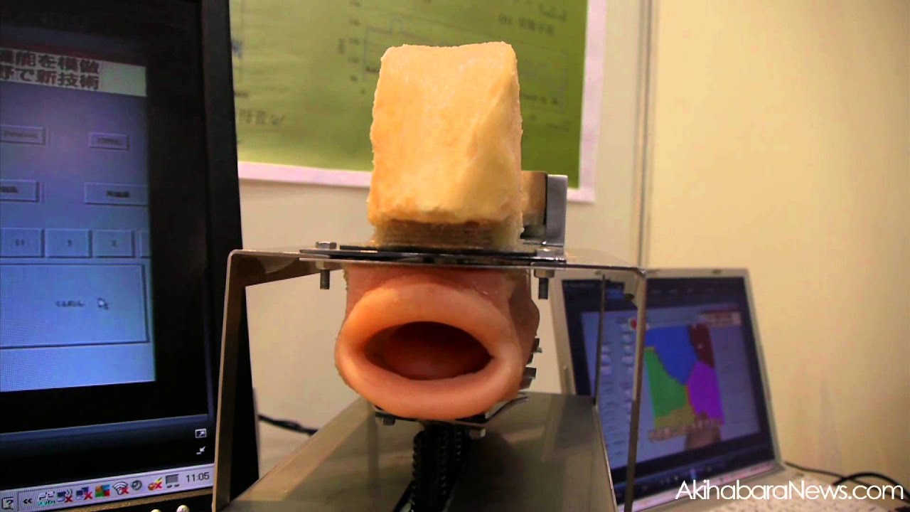

that video creeps me out. seriously. one ugly robot-thingy.

That video is way creepy. Interesting tech though!
