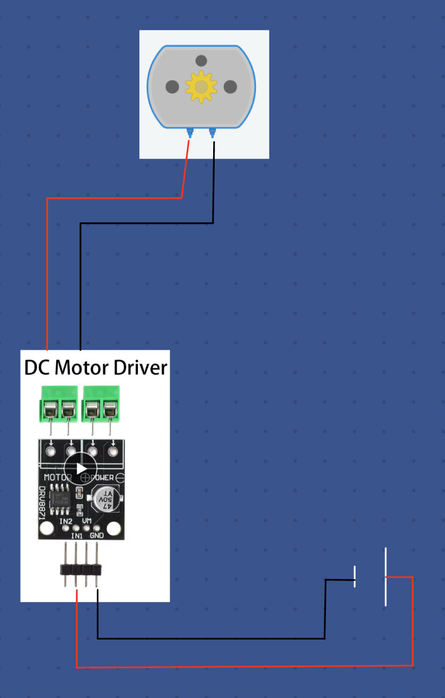

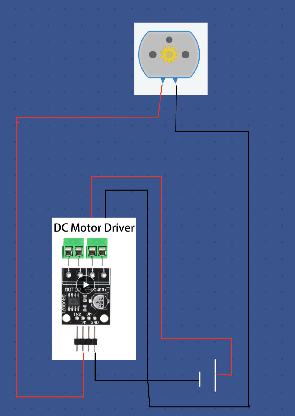

Can I ask if this is what you were referring too? Or have I missed the mark completely,
Option 1
Option 2
Sorry, I am new to this stuff.
in your images, the board has 2 green screw terminal connectors at the top and a header at the bottom.
the motor should be connected to the top left connector. the image below shows that it is marked "MOTOR". the 12V power should be connected to the top right connector, the image below shows the + and - terminals
i'm suggesting that use a wire to connect the VM pin to either IN1 or IN2 and see if the motor runs. it should run in one direction when VM feeds IN1 and run in the opposite directioin when it feeds IN2
