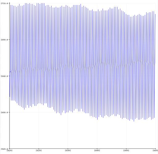

I have updated the code using the suggestions of wvmarle (see code below). I also attach a screenshot of the speed readout that still look strange to me. wildbill do you know what next I can improve?
Robin thanks for your suggestion. My goal is to get to a point in which I can have a speed measurement after every pulse from the encoder. If I only measure once per revolution then I cannot see variations within the rotation. This is the same as in my code choosing 12500 counts.
DrDiettrich I do not know what the aim of your comments is. I linked the specs in the first post and I did not produce the encoder myself. Companies make them and people buy them. I can only say mine is not 7m in diameter. I could dive into deeper explanation on how things are made and why it is not 7m diameter, but I honestly do not see why I should.
Thanks guys!
PS: I still have not changed RISING to CHANGE because I do not think it matters at the moment and it only increases the number of things the arduino has to see.

You have ignored the advice in reply #11 regarding making a copy of your counter variable with interrupts disabled.
DrDiettrich Here's the encoder I'm working with: datasheet. It's nominally 2000ppr, but triggering on both A and B pulses on rising and falling edges gives 8000. It's hard to tell from the pictures, but the spec says it's 40mm in diameter. I've no idea what's inside it though.
wildbill:
I understood the copy of the counter was used when using a volatile long. As suggested I moved instead to volatile byte. As far as understood this should not have the same issue. Did I misunderstand?
Using a byte should be ok. Time's still passing though and there may be an additional interrupt after you store micros. Personally, I'd still stop interrupts while I took a copy. YMMV.

Thanks wildbill. I added the copy and now all checks and calculations are done on a long copy of counter. The result seems the same and I still see oscillations as in the capture I attached before.
Did you encounter this before?
In your project are you measuring the speed after every pulse?
