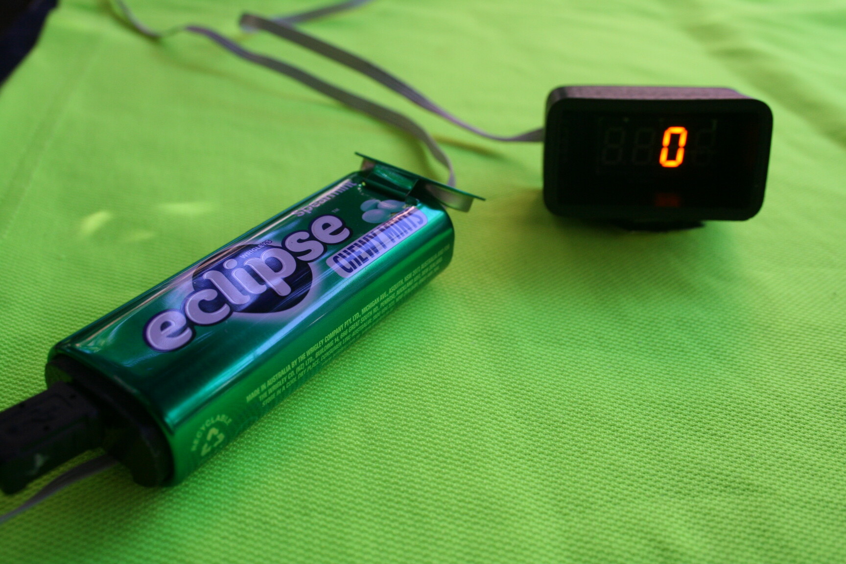

I've tried white, blue and yellow (more like orange). All work. My preference is white as I always wear dark glasses driving. It's crisp. Red would be okay.
It has to be in deep shade -- just isn't readable in sunshine. I made a 3D printed hood. Inside this it works well and looks good.
You're right about being too bright at night, especially white. A light sensor and auto dimming is a good idea.
I've been using this on my car n one form or another for nine months, so the sensor side is well bedded in. It's a Hall Effect sensor and magnet. I did use GPS initially which has some advantages (and some disadvantages) and am developing a well finished unit using GPS.
Something that surprised me is how effective the speed display is compared to the car's analogue speedo. I never would have thought that reading the car's speedo was a time-consuming task, but it is. With the briefest of glances at the LED display I know the speed.
A couple of pics below. The electronics package is inside the mints tin.
John.
