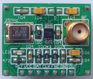

I am trying to control my AD9833 with Arduino Nano.
I bought a AD9833 board and I am trying to wire it to Arduino.
What are A3, A2, A1 here in this image? Are they A1,A2,A3 on Arduino Nano?

Yes.
FSYNC is called SS on the arduino and is pin 10 on the nano (though you could use any spare digital pin for this but this pin (10) must be set to output for SPI to work how you want.).
SCLK is called SCK on arduino and is pin 13 (you must use this pin for hardware SPI).
SDATA is called MOSI on arduino and is pin 11 (you must also use this pin for hardware SPI).
Have a look here for pin mapping of nano.
Look here for details of SPI library.
This is the only circuit of the module I found.
REF -->...................... ???
VCC --> .....................5VDC 3.5-5.5V power supply
SDATA -DAT --> .....D11 - MOSI - physical pin 15
SCLK - CLK --> .......D13 - SCK - physical pin 13
FSYNC - FNC -->....D10 - SS - physical pin14
GND --> ...................Ground

I cannot see REF on the image link you supplied and the AD9833 chip does not have a REF pin.
I will take a wild guess and assume it's pin 7 on the module (referring to your image) and it's a copy of the reference clock signal fed to the AD9833 from an onboard crystal oscillator. You don't need to connect this to anything if it is.
I am just curious about the REF pin in case I want to synchronize something with the AD9833 module's crystal.
For those who are working in a similar project:
REF is connected to the output pin of the crystal, along with the MCLK of AD9833 (w/resistor)

Out of curiosity I bought a AD9833 module (see picture) and cobbled together some code to test it that is attached to this post. I hooked it up to a mega as per pinout in sketch and tested various frequencies using DSO scope that could only handle upto 4MHz. Hope this is of some help.
sketch_jul23a_AD9833.ino (2.42 KB)
