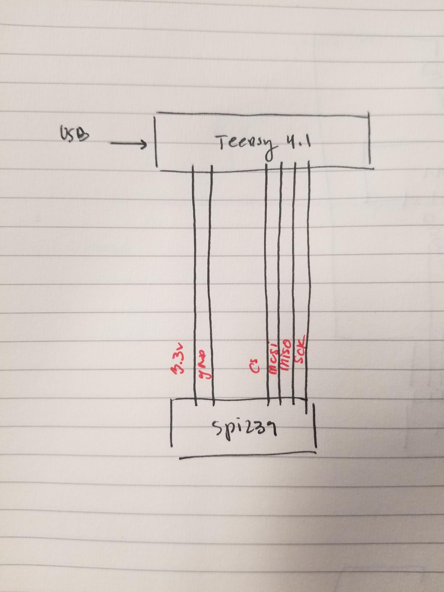

Hello,
I have been using the INA239 current sensor via SPI to a Teensy4.1 board successfully with a wire length of about 5 inches. The strange thing is that, if I extend the wire length to 12 inches, I can see on the oscilloscope that the MOSI line stops working and stays relatively low voltage around 1.8 volts when my power is 3.3V. I then get nothing from the SPI communication after that.
The datasheet for the INA239 states that the data is shifted out on the Rising edge and data is sampled on the Falling edge, and I believe I have the settings correct.
SPISettings INA239_settings(1000000, MSBFIRST, SPI_MODE1);
Any thoughts on why the MOSI line dies down after adding 7 inches to the length of the wire?

IDK, for a question like this, surely you should show us the wires...
Hi what do you mean? like my connections? or the type of wire?
Please read the forum introductory guidelines document about how to post a question. It explains it better than I can.
The type of wire. Thinner is better.
Basically what you encountering in the capacitance of the wire.
Capacitance is a phenomena which takes place on the surface of the metal. The wire starts to act like a capacitor (energy storage unit basically) , the more surface the more capacitance (the type of metal also is a factor, but the surface size is dominant)
Try a solid, thin wire.
I'm sure you know, a solid, thin wire can still easily be configured in a very bad way. And, we don't know what kind of wire it now is. You can not make assertions about capacitance without knowing how the wire is laid out in 3d space.
I think, it's perfectly fair to ask for images.
Also if the DC voltage goes to 1.8V under these circumstances, capacitance can't be a factor. The actual problem here is the lack of details. That is why a reference to the forum guidelines is not just a knee jerk reaction.
Wiring error. Post a schematic diagram and a clear, focused, close up photo of your setup.
I am pretty sure I have the wiring connections connected to the right pins.
Teensy 4.1 SPI pins
10 - CHIP SELECT
11 - MOSI
12 - MISO
13 - CLOCK
Teensy mcu -> ina239 sensor connection
10 -> CS
11 -> SDI
12 -> SDO
13 -> SCK
Below are the photos I took of my setup.
