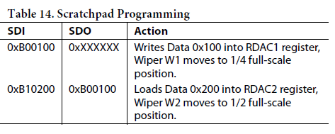

ok. maybe time to go back to the drawing board. if you look at the datasheet (https://www.analog.com/media/en/technical-documentation/data-sheets/AD5235.pdf) have a try of this example:
in code it would be something like this (not tested):
   AD5235_NANO SPI connections:
     CLK - CLK
     SDI - MOSI
     SDO - MISO
     SS -  Pin 10
#include <SPI.h>
  SPI.beginTransaction(SPISettings(4000000, MSBFIRST, SPI_MODE3)); //CLk: 4MHz, MSB first, SPI_MODE3 (CPHA:1, CPOL:1)
  pinMode(SS, OUTPUT); //SS is pin 10
  digitalWrite(SS, HIGH);  // ensure SS stays high for now
  delay(1000); //arbirtrary delay
  //reset all wipers
  digitalWrite(SS, LOW);
  SPI.transfer(0x80); //reset command byte
  SPI.transfer(0x00); //dummy data
  uint32_t cmd;
  //update wiper1 value (channel 0):
  cmd = 0x00B00100;
  SPI.transfer((uint8_t)(cmd >> 16)); //command byte
  SPI.transfer((uint8_t)(cmd >> 8));  //upper data byte
  SPI.transfer((uint8_t) cmd);        //lower data byte
  //update wiper2 value (channel 1):
  cmd = 0x00B10200;
  // do nothing
do the wiper values change as described in 'Action'?

I tried, and still no change. Btw, Pot1 is at 1/2 scale & Pot2 is at 1/4 scale (which is the opposite of what the code suggests, and even if I change the code, nothing change), so I suppose that it's the default value.

  SDI - MOSI
  SDO - MISO
  CS -  Pin 10
  RDY - Pin 9
for demo purposes, have the AD5235 A1 and A2 tied to Vcc, B1 and B2 to GND
  with this arrangement, you should be able to monitor W1 and W2 voltage output as the pot resistance changes
//EEMEM No.--Address--EEMEM Content for …
//1    0000    RDAC1
//2    0001    RDAC2
//3    0010    USER1
//4    0011    USER2
//15    1110    USER13
//16    1111    RAB1 tolerance
//Control Registers
#define CMD__NOTHING  B00000000 //0  - Do nothing
#define CMD_MEM2RDAC  B00010000 //1  - Restore EEMEM (A0) contents to RDAC (A0) register. See Table 16.
#define CMD_RDAC2MEM  B00100000 //2  - Store wiper setting. Store RDAC (A0) setting to EEMEM (A0). See Table 15. - Use a delay of 50ms!!!
#define CMD_USER2MEM  B00110000 //3  - Store contents of Serial Register Data Byte 0 and Serial Register Data Bytes 1 (total 16 bits) to EEMEM (ADDR). See Table 18.- Use a delay of 50ms!!!
#define CMD_DECRE6DB  B01000000 //4  - Decrement by 6 dB. Right-shift contents of RDAC (A0) register, stop at all 0s.
#define CMD_DEALL6DB  B01010000 //5  - Decrement all by 6 dB. Right-shift contents of all RDAC registers, stop at all 0s.
#define CMD_DECR1STP  B01100000 //6  - Decrement contents of RDAC (A0) by 1, stop at all 0s.
#define CMD_DECA1STP  B01110000 //7  - Decrement contents of all RDAC registers by 1, stop at all 0s.
#define CMD_ALL2RDAC  B10000000 //8  - Reset. Refresh all RDACs with their corresponding EEMEM previously stored values. - Use a delay of 30us!!!
#define CMD_GETEMEM  B10010000 //9  - Read contents of EEMEM (ADDR) from SDO output in the next frame. See Table 19. - Use a delay of 30us!!!
#define CMD_GET_RDAC  B10100000 //10 - Read RDAC wiper setting from SDO output in the next frame. See Table 20. - Use a delay of 30us!!!
#define CMD_SET_RDAC  B10110000 //11 - Write contents of Serial Register Data Byte 0 and Serial Register Data Byte 1 (total 10 bits) to RDAC (A0). See Table 14.
#define CMD_INCRE6DB  B11000000 //12 - Increment by 6 dB: Left-shift contents of RDAC (A0),stop at all 1s. See Table 17.
#define CMD_INALL6DB  B11010000 //13 - Increment all by 6 dB. Left-shift contents of all RDAC registers, stop at all 1s.
#define CMD_INCR1STP  B11100000 //14 - Increment contents of RDAC (A0) by 1, stop at all 1s. See Table 15.
#define CMD_IALL1STP  B11000000 //15 - Increment contents of all RDAC registers by 1, stop at all 1s.
#define CS 10
#define RDY 9
#include"SPI.h"
uint8_t myVal = 0;
  //Setup SPI and start it
  pinMode(CS, OUTPUT);
  digitalWrite(CS, HIGH);
pinMode(RDY, INPUT_PULLUP); //that way you don't need use a external pullup resistor on this pin
SPI.begin();
delay(15);
  setWiper(0, 999);
  setWiper(1, 333);
  Serial.print("W1 Value : "); Serial.println(getWiper(0));
  Serial.print("W2 Value : "); Serial.println(getWiper(1));
  stepUpOne(0);
  stepUpOne(1);
  Serial.print("Increase W0 with 1 : "); Serial.println(getWiper(0));
  Serial.print("Increase W1 with 1 : "); Serial.println(getWiper(1));
  stepUpOne(0);
  repeatCMD();
  stepUpOne(1);
  repeatCMD();
  Serial.print("W1 after repeat : "); Serial.println(getWiper(0));
  Serial.print("W2 after repeat : "); Serial.println(getWiper(1));
  stepDownSix(0);
  stepDownSix(1);
  Serial.print("Decrease W0 with 6dB : "); Serial.println(getWiper(0));
  Serial.print("Decrease W1 with 6dB : "); Serial.println(getWiper(1));
  stepDownSix(0);
  repeatCMD();
  stepDownSix(1);
  repeatCMD();
  Serial.print("W1 after repeat -6dB: "); Serial.println(getWiper(0));
  Serial.print("W2 after repeat -6dB: "); Serial.println(getWiper(1));
SPI.end();
void setWiper(uint8_t w, uint16_t value)
  digitalWrite(CS, LOW);
  myVal = SPI.transfer(CMD_SET_RDAC + w);
  myVal = SPI.transfer(value >> 8);
  myVal = SPI.transfer(value & 0xFF);
uint16_t getWiper(uint8_t w)
  uint16_t ret;
  myVal = SPI.transfer(CMD_GET_RDAC + w);
  myVal = SPI.transfer(CMD__NOTHING);
  delayMicroseconds(30);
  myVal = SPI.transfer(CMD__NOTHING); //Discard first byte
  ret = (SPI.transfer(CMD__NOTHING) << 8);
  ret += SPI.transfer(CMD__NOTHING);
  return ret;
void stepUpOne(uint8_t w)
  myVal = SPI.transfer(CMD_INCR1STP + w);
void stepDownSix(uint8_t w)
  myVal = SPI.transfer(CMD_DECRE6DB + w);
void repeatCMD()//See page 21 in manual Another subtle feature of the AD5235 is that a subsequent CS strobe, without clock and data, repeats a previous command
