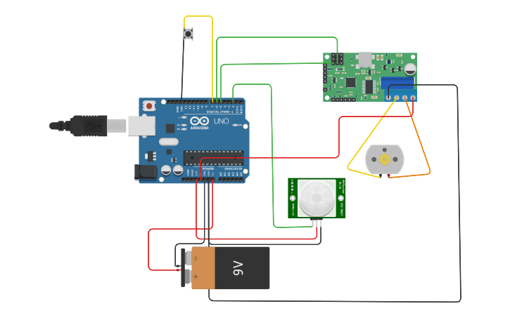

I'm having some problems with getting my system to run.
Either it's the code or my circuit.
Please see here the schema and the code:
Spider drop - not working | Tinkercad
There is no error notice from the codesite.
I suspect the error in the motor controller, but i'm ot to sure with this.
Hope somebody can see the mistake i did.
Thanks in advance!

What should happen is, that the PIR detects a movement and the motor should turn.
But, in my simulation the motor does not turn on.
9 Volt battery should be more than enough to get both running.
Please see here the code:

Hello!
Thank you for the information. I definitely did not understand all of it (or better how to to it) but i will try to follow.
I tried to get this code via single parts and they worked, so i'm pretty sure that i the whole code should work.This is my first time programming an arduino. Normally i'm working on raspberry, but with all the updates i do not know anymore which version i need to use (apt sudo install python3 (or python, or whatever).
Anyway, i think my installation went wrong. Thats why i included the Link to Tinkercad and made it public. Maybe someone can check more on this.
Thanks

Hello alto777,
thx, i need to test this out.
I did everything from start and it works...until the part with the motor controller comes.
Wish Tinkercad had also my motor driver MX1508 as part. I really think that i mix something up with the polulu motor controller.
