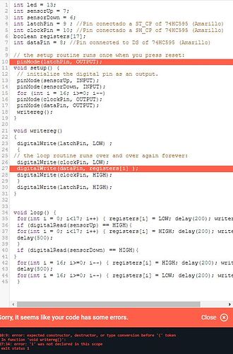

Hi. First of all, I wrote this through translation, so there may be some typos. There is a stair step tracking led system. I've done this before and it worked. But now when I do it again as a project, I get the following error. I don't know how to write code. Would you help me with this topic?
Code Here

This is warning?
10:9: error: expected constructor, destructor, or type conversion before '(' token
 In function 'void writereg()':
27:34: error: 'i' was not declared in this scope
 exit status 1
That pinMode should be inside setup ()
As for the other one, it's hard to tell what you're trying to do.
You seem to have a loop-related comment in the writeReg function.
That seems odd.
registers is a Boolean array - you should not be assigning the values HIGH or LOW to its elements.
Thank you very much for your quick reply. I made the first edit. Can you check the project for the other one?
I don't do TinkerCAD - you need to post your code.
